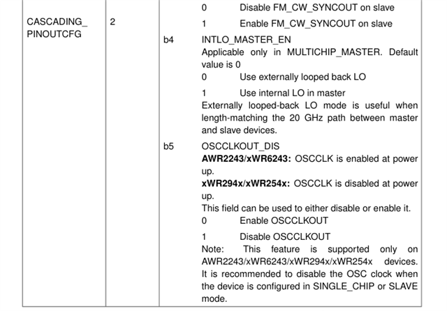

For lab testing, I'd like to enable OSC_CLKOUT on the AWR2544LOPEVM. How can I enable this output?
For AWR18/IWR68, disabling the MPU and writing to a magic address was required. Is the procedure for AWR25 similar?
