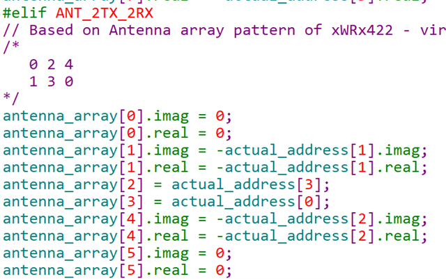

  • Hi Tim,
    1. From the copyData_after_2DFFT function in aoaprochwa.c, I saw that the program outputs the value of each virtual array for filtered points (default is 25 points).Please see the actual_address variable in the image above.
    I've figured out that the actual_address input is a signal, but I can't find the relevant code for doppler compensation.
    2. I have seen the E2E post you provided.
    But at the end, he said that because his waveform is set to DDM (Doppler division multiplex) MIMO, there will be no doppler compensation. However, the default setting in gesture_recognition is TDM, so doppler compensation will be generated. In the program and document Doppler compensation is also mentioned (as shown below), so do you mean that doppler compensation is not actually performed in gesture_recognition?
    You are correct - I did not realize that other thread was not TDM.
    Let me look at this some more, and I will provide some feedback next week.
    Tim

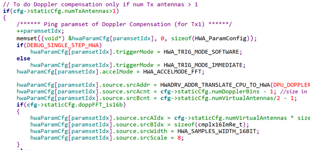

    I was able to take some more time to look into this.
    Doppler compensation is indeed performed in this gesture demo. The coefficients for doppler compensation are calculated in VectorMult_gen() in gesture_recognition.c.
    You'll see below as well we then set those coefficients to be used in the HWA for the vector multiplication. The vectorRam variable is then used in the aoaprochwa.c to perform the compensation inside the HWA.
    I hope this helps,
