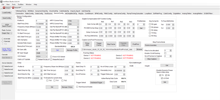

I have MMWCAS-RF-EVM and MMWCAS-DSP-EVM boards and I am trying to set them up with the help of mmWave Studio.
(mmwave_dfp_02_02_04_00, mmwave_studio_03_00_00_14)
I was able to run the Cascade_Configuration_MIMO.lua.
I opted to use the GUI to configure TDA, but when I get to the point where we have to click "TDAxxARM" I'm getting the following output.
[RadarAPI]: ar1.TDACaptureCard_StartRecord_mult(15, 0, 0, adc_data, 0)

I have also included screenshot showing the 4 x chips connected via SPI + the Sensor config page.
