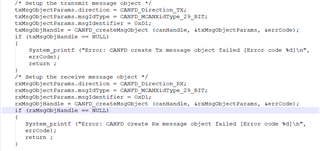

  • Hi Kristien,
    Please find the attached images below for mcanCfgParams, mcanBitTimingParams, and rxMsgObjectParams and txMsgObjectParams,
    I have verified those two points also, everything is fine.

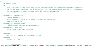

    I have one query regarding CANFD_Init function. Please find the screenshot below,
    Above this function there is a comment mentioned that "Currently only 1 instance of CANFD is supported. Valid value is 0." So is there possibility of having same instance id which are clashing on CAN bus and at a time only one CAN RADAR is communicating on CAN BUS. Because of having same instance id, the one who win the CAN bus access will be able to communicate and not the other one.

  • Hey Manoj,
    The CAN-FD driver should support being able to use both CAN instances simultaneously, though I've only personally tested using the two transceivers on two separate buses. If you want to instantiate the second CAN transceiver, you will have to call CANFD_init again with ID 1 and setup new bit timings and message objects for it. You can see an example of how this is done in the 6843 CAN-FD driver binary unit test (<MMWAVE_SDK_INSTALL_DIR>/packages/ti/drivers/canfd/test/xwr68xx/main.c) under the mcanDualMsgIdRangeTest and mcanDualMultiTransmission functions.
    I also wanted to clarify that when you only get data from one transceiver, i.e., the first one to power on, do you only get data from that one transceiver for the entirety that all transceivers are on? In other words, until you power cycle all nodes simultaneously, the first node on, or perhaps the oldest node, will have priority?
    Have you checked the signals on the bus to verify whether this behavior could be linked to arbitration? Keep in mind that all nodes read back the bus value when transmitting identifier and RTR bits, and a node will stop transmitting if it transmits a recessive bit but reads back a dominant bit.
    Kristien

  • Hey Manoj,
    So, what I understood from this is having same instance ID is not an issue, right? That means having same instance ID for multiple RADARs "CANFD_init(0, &mcanCfgParams, &errCode);" is fine. Let me know if my understanding is correct.
    That is correct. The instance ID is used to address which CAN transceiver to use on the device, i.e., either CAN 0 or CAN 1.
