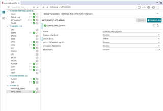

  • I've been on CSS - I've Imported the MPD demo into CSS and then opened sysconfig and enabled QUICK_EVAL.
    In the mmwave_cli.c file I see the config characters already populated so thats good.
    Now I'm trying to generate an .appimage, this isn't mentioned anywhere though. Can you let me know?
    I've built the file in CSS but can't find any appimages. I do see in the SDK folder I have on my C:/ that the respective mmw_demo folder does have appimages though.
    And is there anyway to check the hardconfig flash worked - like in the radar toolbox example

  • Hey, could you let me know how to make the .appimage please? I've built it in CSS but cant find the .appimage
  • Hi Fred,
    If you have built the demo in CCS you should be able to find the .appimage at in the project directory in your CCS workspace. This will depend on where you have specified your CCS workspace but by default it should be located at:  C:/Users/{USER}/{CCS WORKSPACE}/{PROJECT}/{BUILD CONFIGURATION}
    The build configuration will either be 'Release' or 'Debug' So look for a folder with one of those names in your project folder. You should find the .appimage file within.

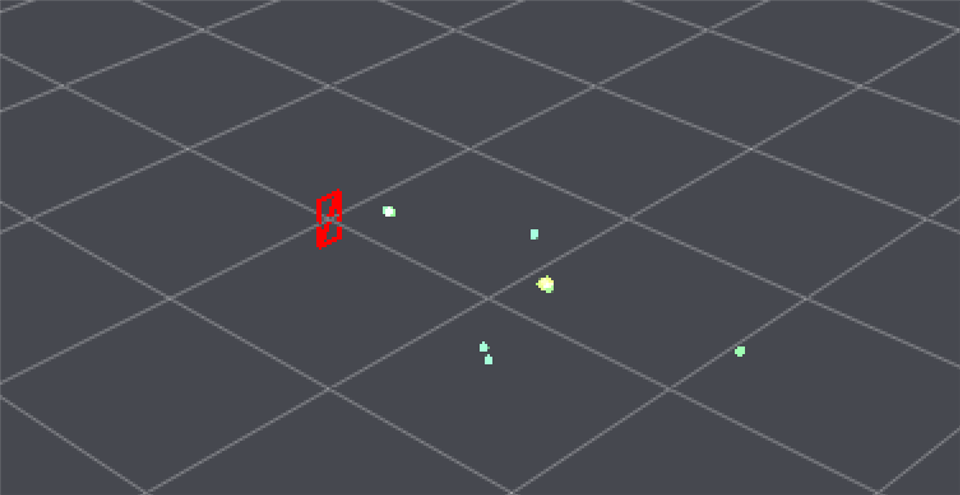

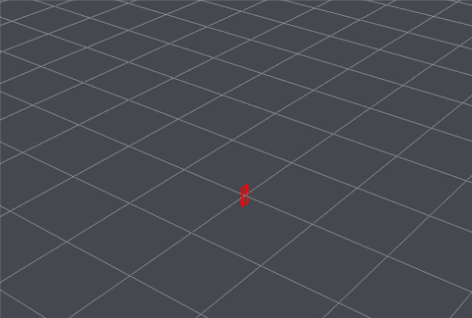

  • Hey Josh,
    I've loaded up the GUI from radar tool box.
    I'm connected and receiving frames,
    but nothing is showing:
    got it working, probably the GUI part of the config that I changed.

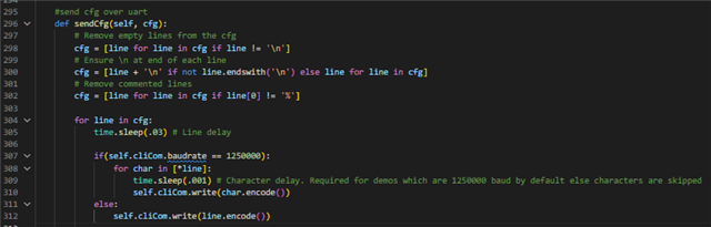

  • So for baudate,
    within mmw_cli.c there is no cfg item that states Baudrate = xyz.
    However there is this define in the code:
    #if (FEATURE_LITE_BUILD_EN == 0)
    //Enable this define, to allow dynamic swith to 1.25Mbps baud rate, then execute CLI cmd: baudRate 1250000
    #define ENABLE_UART_HIGH_BAUD_RATE_DYNAMIC_CFG
    And i've just checked my sysconfg - it was set at 115200.
    So according to this - there should be a discrepancy and hence the crash?
    The only baudrate I see is in gui_parser and it says
        def sendLine(self, line):
            if(self.cliCom.baudrate == 1250000):
                for char in [*line]:
    So I think this might have been where the discrepancy was happening. I'll edit sysconfig and try.
    For the unplug question - yes Im running on python code. I'm reading and parsing the cfg and then running detected points well.
    But if I Ctrl+C the program on python terminal, I cant just restart it. I've got to unplug it and plug it in.
    So I'm guessing theres some sort of closing loop that needs to be done.
