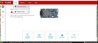

  • Hi Toshiro-san,
    After putting the device into DFU mode and clicking on the File dropdown menu in the GUI shown below, is the Program Device greyed out like below?
    ~Alicia
  • Hi Alicia-san,
    I have checked but the "Program Device" in not greyed out. the color is black.

  • Hi Toshiro-san,
    Can you try clicking the "Program Device" button? This should hopefully allow you to program the device with the necessary software, You'll just need to make sure that you are in DFU mode first before hitting that button.

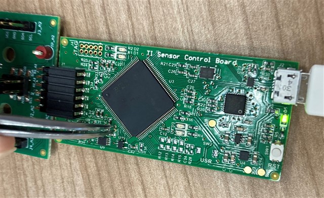

  • I tried to turn into DFU mode, but D1 did not ON state shown below.
    So I cannot move on next.
  • Hi Toshiro-san,
    When in DFU mode, the only LED that should be on is D5, which looks like is the case based on the picture above. When in DFU mode, the 'Program Device' button should no longer be greyed out and should appear black. From here, you should be able to press that 'Program Device' button which should then download the necessary firmware for the TMAG3001EVM GUI.

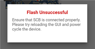

    I tried to run Program Device when SCB turns into DFU mode by checking only D5 ON, However it was failed
    1. click "Program Device"
    2. failed program device
    could you tell me how I can take care.

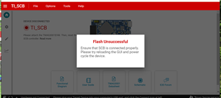

  • Hi Justin-san,
    I reached to File -> Program device option in your suggestion above. However it stopped by "Flash unsuccessful" message in below.
    Regarding to GUI update, if this means "BSL_FLASH_APPLICATION.bat", update was failed.
    One curious thing is D1 is always off but only D5 is on, even USB initially plugged in.

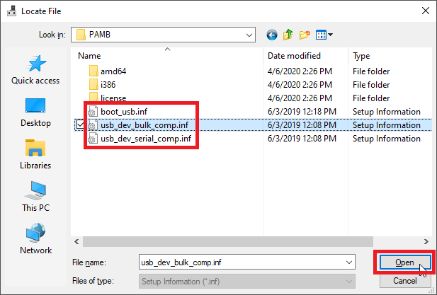

    I tested with a few new computers until I found one that had similar issues to yours. I found a couple windows 11 machines that exhibited the behavior but not all windows11 computers had the issue. For the ones that did, the PAMB drivers were properly installed except for when the device was in BSL mode which would cause the firmware updates to fail. To fix this, you need to first put the SCB into BSL mode (either through a failed firmware update or through shorting the pins). When the SCB is in DFU mode, it would show as an unknown device in device manager:
    Then, follow the steps in the https://e2e.ti.com/support/data-converters-group/data-converters/f/data-converters-forum/914940/faq-how-do-i-resolve-pamb-evm-connectivity-and-or-driver-installation-issues FAQ, but when you get to step 8, please use "boot_usb.inf" for the driver.
    Once you complete the driver assignment for the SCB in BSL mode, you can proceed to flash the SCB as normal through the GUI.

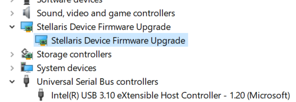

  • Hello Toshiro-san,
    The driver issue I mentioned in my last reply was just while the SCB was in it's BSL mode. I haven't noticed that same issue on a Windows 10 Pro computer yet but that doesn't mean it couldn't happen.

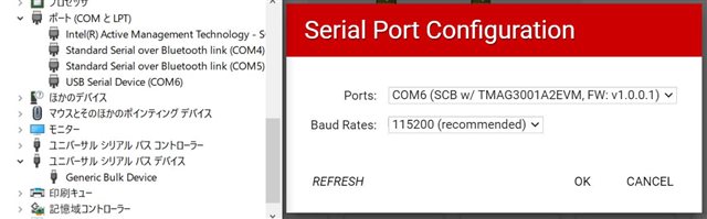

    While you double check the drivers and check if another computer or other ports experience the same issue, if the SCB does not show up as an unknown device at any point during operation (normal operating mode or BSL mode) then the drivers are most likely installed properly. During normal operation (D1 is on), the SCB should show up as both USB Serial Device and a Generic Bulk Device in the device manager. When the SCB is in BSL mode, it will show up as the firmware device. Here is an good example of each case:
    Normal Operation:
    BSL Mode:
    Note. It can also show up as TivaWare Device Firmware Upgrade instead of Stellaris
    Justin Beigel

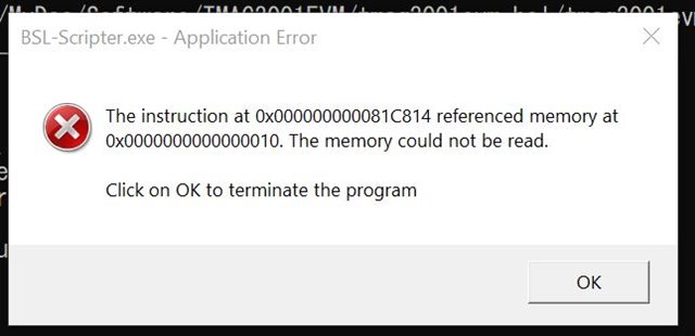

  • Hello, Justin-san,
    I tried again following to your suggestion and SCB seems to be in BSL mode since I could see in below.

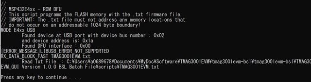

    However "program Device" did not run
    I also run ".bat" file down loaded from "">www.ti.com/.../TMAG3001EVM-BSL" but it did not run by a error masage in below.
    I did same thing in another USB port but same thing was happened again.

    Earlier you mentioned that D1 was always off, even when initially plugged in. Does D1 remain off even if you press the RST button?
    -> Yes. D1 remain off state even if USB plugged in again. While pressing RST and all other LDSs are brinking, SCB seems to be in normal mode since I could see "Generic Bulk Device" below. SCB turn to BSL mode soon after these brinking was finished and D5 on state.

  • Hi Toshiro-san,
    When you were manually installing the drivers from the How do I resolve PAMB EVM connectivity... FAQ, did you install all three of the files shown below, or just one?
    Could you try pressing the RST, and while the other LEDs are flashing, force the device into BSL mode by shorting the 2 gold pins and pressing the RST button?

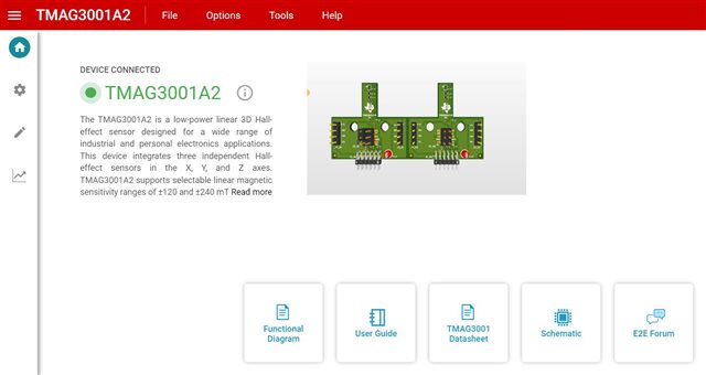

  • Hi Alicia-san.
    I did the instruction on above several time and finally the GUI was lauched up as shown in below. In addtion, D1 tunrs ON then I thisnk the firmware was updated and the EVM tunes into nomral operation.
    I think my issue may be resolved.
    T.Imi
