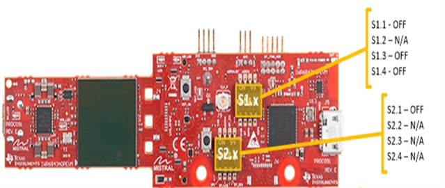

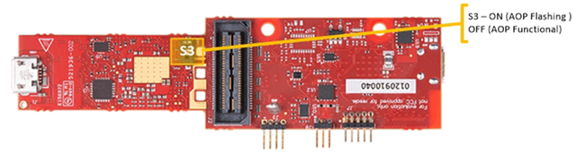

  • its the python one in the radar toolbox main_gui.py  under aplication visualisers industrail visualisers
    i've wasted 6 days chasing my tail i'm going to take the unit off the MMWAVEICBOOST board and try it later today if that fixes my problem .. and the damn gui works all good otherwise i might as well throw it in the bin i dont have time to play i need a working demo that someone who know what they are doing can do somthing with ..
  • Hey Adrian,
    I understand your frustration here regarding this issue, and I will try my best to resolve it, but please abide by the E2E guidelines and general forum etiquette - i.e., be courteous.
    For the industrial visualizer from Radar Toolbox versions at or above 2.XX.XX.XX, you will need to specify the full path of the USB ports. Without the MMWAVEICBOOST, the ports should be: /dev/ttyUSB0 and /dev/ttyUSB1. For Radar Toolbox versions prior to 2.XX.XX.XX, specifying the port path was not possible as the visualizer only supported Windows OS. Note: we are working towards improving Linux support for our devices, but there will be issues, so posts like this help us understand what gaps exist.
    Additionally, if you are trying to connect multiple visualizer instances to one device, that will fail, as only one visualizer can hold the USB ports at a time. If you are trying to connect multiple visualizers to multiple devices, that should work, but they will likely slow down according to how many devices and visualizers you have running.
    Kristien
  • i appologise for my strong language im australian .. and my natual language does not translate well to polite folk who dont know me .. however /dev/ttyUSB0 and /ttyUSB1 which is what maps acordeinf to /dev/serial/devby-id ... to silicon labds dual .... does not send data to the main_gui.py app prthon 3 ahs lots of complaints .. about no data. perhaps my switches are now wrong as the mmwboost bourd is not in the equation
  • Hey Adrian,
    Its all good! I'm glad you explained your situation. You are right about having to change the board settings when removing the MMWAVEICBOOST. You'll have to set the board switches as shown in the image below and also ensure the flashing switch on the back is set to OFF. If you ever need to check switch settings for flashing and functional modes, I would recommend checking out the EVM Setup Operational Modes guide from the Radar Toolbox.
    I also confirmed on my end that attempting to run the visualizer without changing the switches from the settings used for the MMWAVEICBOOST will cause the visualizer to complain about no data. Changing the switch settings to the above allowed me to get visualizer data.
    Additionally, you can uncomment the print statement on line 107 of parseFrame.py found under <RTB_INSTALL_DIR>/tools/visualizers/Applications_Visualizer/common/ and then run the Python visualizer, gui_main.py, from source to see what TLVs the visualizer is receiving.
    Lastly, I just wanted to confirm again that you are not using a Radar Toolbox version below 2.00.00.06, correct? If you are, please download the latest Radar Toolbox version which does support Linux.
