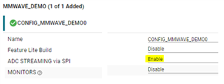

  • IWRL1432 Boost with flashed demo (changed sysconfig and compiled in CSS, then flashed in visualizer GUI with built .appimage):
    “motion_and_presence_detection_demo_xwrL14xx-evm_m4fss0-0_freertos_ti-arm-clang”
    ->sysconfig changed in CSS with ADC Streaming via SPI enabled:

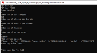

    adcDataSPIFTDI.exe:
    Tried different Parameter Settings. .txt is generated but only containing “-1”
    adcdata.txt is generated with only containing “-1”

    from: xWRL1432 MMWAVE-L-SDK  05.04.00.01/ RAW ADC Streaming/Steps for SPI based streaming i used this:
    • Ensure that switch S1.6 is ON.
    • Run the demo and use configuration with "adcLoggging 2" to enable this feature.
    • Run the adcDataSPIFTDI.exe application located in tools/spi_adc_streaming folder after issuing the configuration (via Visualizer or serial term etc.) and before the sensor start command is sent to device.
    • Give all the inputs to adcDataSPIFTDI application like Device Type, Number of ADC samples, Number of chiprs in burst, Number of burst in frame, Number of Frames, Number of Rx Antennas as given in configuration file. Ensure that this is done before "sensorStart" comamnd is sent.
    • After the demo starts, Raw ADC Data for given number of frames will get stored in a adcData.txt file in spi_adc_streaming folder.

    I know you said you are making the changes and then building, but are you building the demo after making the sysconfig changes or before?  Currently if you enable spi streaming in the base MPD demo, it will fail and a couple of errors will have to be resolved.  Have you 1) made sure you are building the demo after making the sysconfig changes and 2)resolving the errors seen when the demo builds?

    2 How do I use adcDataSPIFTDI.exe with TeraTerm/CLI Tool/Visualizer.exe to get raw Data via SPI? Is it necessary to also activate MCSPI in syscfg?
    MCSPI does not need to be enabled as enabling ADC data streaming over SPI will enable sections of code that manually enable and configure MCSPI.  Can you try following the suggestion from the first question and see if that resolves your issues?
