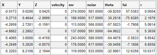

I have got point cloud and ADC raw data simultaneously using AWR1843AOP+DCA1000EVM.
Point cloud data with range CFAR=15dB setting is the following image;
Also, I understand that "dB unit of SNR" is "SNR of DPIF_PointCloudSideInfo" / 10 from the following thread;
https://e2e.ti.com/support/sensors-group/sensors/f/sensors-forum/1382079/awr1843aop-peakval-variable/5289608?tisearch=e2e-sitesearch&keymatch=%20user%3A560047#5289608
Q) When r(Range) is 5.0914, snr is 113 from the above point cloud data.
 Thus, "dB unit of SNR" is 11.3dB. I have Range CFAR set to 15dB.
 Why is target detected with SNR below CFAR threshold(15dB)?
Please advise.
Shoko

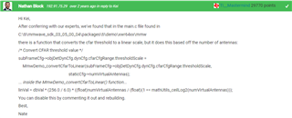

  • Hello Cesar,
    Is my problem the same as the following thread? I'm using three TX antennas in AWR1843AOP.
    Is it a bug of the main.c??
    https://e2e.ti.com/support/sensors-group/sensors/f/sensors-forum/1123346/iwr6843aopevm-cfar-ca-or-cfar-caso
    Shoko

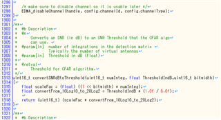

  • Hello Cesart,
    I have found the parameter "* 3/4" in main.c of mmwave_sdk_03_06_02_00-LTS\packages\ti\datapath\dpc\objectdetection\objdethwa\test.
    (Please see the following image. )
    Is it related to detecting target with SNR below CFAR threshold(15dB)?
    If yes, please let me know in detail the need to adjust thresholdScale when numTXAntenna is 3.
    I can't understand it with only the comment in main.c.
    Shoko

  • Hi Shoko
    Please try to comment out the code that is specified in the prevoius E2E you sent.
    e2e.ti.com/.../iwr6843aopevm-cfar-ca-or-cfar-caso
    Specifically the instruction specified here and let me know if that resolves the issue. Once commented out, rebuild the project and try to run again.
    Gigliotti

    > First, regarding the formula it is just a change of base formula....
    --> No, your explanation is just "*1/6" part of the following fomura.
       linVal = dbVal * (256.0 / 6.0); // * ((float)numVirtualAntennas / (float)(1 << mathUtils_ceilLog2(numVirtualAntennas)));
    I think the core of the "Why is target detected with SNR below CFAR threshold(15dB) when TX antennas is three? " is "* ((float)numVirtualAntennas / (float)(1 << mathUtils_ceilLog2(numVirtualAntennas)))" part of the formula.
    I just want to know any TI documents explaining the part of the formula.
