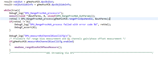

Hi TI engineer :
I'm using sampling code of Capon2D from radar_toolbox_2_10_00_04\source\ti\examples\InCabin_Sensing\AWRL6432_Life_Presence_Detection_Demo_Capon2D\src\xwrl6432,
we burn empty.release.appimage into 6432 BOOST,and ccs 12.6 debug with following switch pin setting
We turn on CLI_ByPassApi with .syscfg setting as following
#define FEATURE_LITE_BUILD_EN 0
#define SPI_ADC_DATA_STREAMING 0
#define QUICK_START 1
#define DYNAMIC_RECONFIG 1
#define ENABLE_MONITORS 0
char* radarCmdString[MAX_RADAR_CMD] =
"sensorStop 0 \r\n",
"channelCfg 7 3 0 \r\n",
"chirpComnCfg 40 0 0 128 4 61.0 1 \r\n",
"chirpTimingCfg 7 24 0 65 57.5 \r\n",
"frameCfg 2 15 4080 16 200 0 \r\n",
"guiMonitor 2 0 0 0 0 1 0 0 0 0 0 \r\n",
"sigProcChainCfg 32 16 2 0 4 16 0 20 \r\n",
"angleHeatmapGenCfg 1 1 -3 3 \r\n",
"clusterCfg 0 0.5 2 \r\n",
"cfarCfg 2 8 4 3 0 9.0 0 1 4 6 2 9.0 0.80 0 0 0 1 1 1 1 0.5 1.5 0.15 \r\n",
"aoaFovCfg -60 60 -60 60 \r\n",
"rangeSelCfg 0.2 2.0 \r\n",
"clutterRemoval 1 \r\n",
"antGeometryCfg 0 0 1 1 0 2 0 1 1 2 0 3 2.418 2.418 \r\n",
"compRangeBiasAndRxChanPhase 0.0 1.00000 0.00000 -1.00000 0.00000 1.00000 0.00000 -1.00000 0.00000 1.00000 0.00000 -1.00000 0.00000 \r\n",
"adcDataSource 0 adc_data_0001_CtestAdc6Ant.bin \r\n",
"adcLogging 0 \r\n",
"lowPowerCfg 0 \r\n",
"factoryCalibCfg 1 0 40 0 0x1ff000 \r\n",
"sensorStart 0 0 0 0 \r\n"

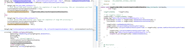

We add some debug message inside the code, and observe the system will hang in DPU_RangeProcHWA_process() waiting edma done semaphore
console debug message
[Cortex_M4_0] Drivers open Get Device Version DPC_Init begin DPC_Init done CLI_init begin CLI_init done inside powerManagementTask Starting the Demo with Default Configurations... InRadar: sensorStop 0 Done CLI_MMWaveChannelCfg: 7 3 0 InRadar: channelCfg 7 3 0 Done CLI_MMWaveChirpCommonCfg: 40 0 0 128 4 610.00 1 InRadar: chirpComnCfg 40 0 0 128 4 61.0 1 Done CLI_MMWaveChirpTimingCfg: 70.00 24576 0.00 65.00 57.50 InRadar: chirpTimingCfg 7 24 0 65 57.5 Done CLI_MMWaveFrameCfg: 2 15 4080.00 16 8000000.00 0 InRadar: frameCfg 2 15 4080 16 200 0 Done CLI_MMWaveGuiMonSel: 2, 0, 0, 0, 0, 1, 0, 0, 0, 0, 0 InRadar: guiMonitor 2 0 0 0 0 1 0 0 0 0 0 Done CLI_MMWaveSigProcChainCfg: 32 16 2 0 4 16 0 20.00 InRadar: sigProcChainCfg 32 16 2 0 4 16 0 20 Done CLI_MMWaveAngleHeatmapGenCfg: 87 89 91 94 InRadar: angleHeatmapGenCfg 1 1 -3 3 Done CLI_MMWaveClusterParamCfg: 0 0 0 InRadar: clusterCfg 0 0.5 2 Done CLI_MMWaveCfarCfg: 2 8 4 3 0 9.00 0 1 4 6 2 9.00 204 0 0 0 1 1 1 1 0.50 1.50 0.15 InRadar: cfarCfg 2 8 4 3 0 9.0 0 1 4 6 2 9.0 0.80 0 0 0 1 1 1 1 0.5 1.5 0.15 Done CLI_MMWaveAoaCfg: 0, -1068630016, 0, 1078853632 InRadar: aoaFovCfg -60 60 -60 60 Done CLI_MMWaveRangeSelCfg: 0.20 2.00 InRadar: rangeSelCfg 0.2 2.0 Done CLI_MMWaveClutterRemoval: 1 InRadar: clutterRemoval 1 Done CLI_MmwDemo_AntGeometryCfg: 0 0 1 1 0 2 0 1 1 2 0 3 2.418 2.418 InRadar: antGeometryCfg 0 0 1 1 0 2 0 1 1 2 0 3 2.418 2.418 Done CLI_MMWaveCompRangeBiasAndRxChanPhaseCfg: 0 1048575 0 -1048576 0 1048575 0 -1048576 0 1048575 0 -1048576 0 InRadar: compRangeBiasAndRxChanPhase 0.0 1.00000 0.00000 -1.00000 0.00000 1.00000 0.00000 -1.00000 0.00000 1.00000 0.00000 -1.00000 0.00000 Done CLI_MMWaveAdcDataSourceCfg: 0 adc_data_0001_CtestAdc6Ant.bin InRadar: adcDataSource 0 adc_data_0001_CtestAdc6Ant.bin Done CLI_MMWaveAdcLogging: 0 0 0 0 2 InRadar: adcLogging 0 Done CLI_MMWaveLowPwrModeEnable: 0 InRadar: lowPowerCfg 0 Done CLI_MMWaveFactoryCalConfig: 1 0 40 0 0 CLI_MMWaveFactoryCalConfig: 1 0 40 0 1ff000 InRadar: factoryCalibCfg 1 0 40 0 0x1ff000 Done CLI_MMWaveSensorStart: 0 0 0 0 rfBandwidth = 3965.00 rampDownTime = 6.00 h_CrdNSlopeMag = 1444 ****************************************** xWRL6432 MMW Demo 05.04.00.00 ****************************************** Platform : XWRL6432 RFS Firmware Version : 07.01.00.04 FECSS Lib Version : 03.01.08.01 mmWaveLink Version : 03.02.00.03 RFS Patch Version : 07.02.00.00 mmWave SDK Version : 05.04.00.00 dpc_task initial DPC Config Initial DPC mmwDemo_rangeProcConfig DPU_RangeProcHWA_config DPU_RangeProcHWA_config 1 DPU_RangeProcHWA_config 2 DPU_RangeProcHWA_config 3 DPU_RangeProcHWA_config 4 DPU_RangeProcHWA_config 5 DPU_RangeProcHWA_config 6 DPU_RangeProcHWA_config 7 DPU_RangeProcHWA_config 8 DPU_RangeProcHWA_config 9 DPU_RangeProcHWA_config 10 DPU_RangeProcHWA_config 11 DPU_RangeProcHWA_config 13 DPU_RangeProcHWA_config 14 DPU_RangeProcHWA_config 15 numDopplerChirpsPerFrame = 1, numMinorMotionChirpsPerFrame = 0, DPParams->enableMinorMotion = 1 numMajorPingPongPaths = 5, pingPongInd = 0 without_EDMA_callback numDopplerChirpsPerFrame = 1, numMinorMotionChirpsPerFrame = 0, DPParams->enableMinorMotion = 1 numMajorPingPongPaths = 5, pingPongInd = 0 without_EDMA_callback numDopplerChirpsPerFrame = 16, numMinorMotionChirpsPerFrame = 16 MM_with_EDMA_callback isIntermediateTransferCompletionEnabled = 1, isTransferCompletionEnabled = 1 numDopplerChirpsPerFrame = 16, numMinorMotionChirpsPerFrame = 16 MM_with_EDMA_callback isIntermediateTransferCompletionEnabled = 1, isTransferCompletionEnabled = 1 DPU_RangeProcHWA_config 16 DPU_RangeProcHWA_config 17 DPU_RangeProcHWA_config 12 numUsedHwaParamSets = 4 DPC mmwDemo_doaProcConfig ========== Memory Stats ========== Size Used Free L3 425984 237712 188272 Local 28672 2416 26256 Tracker 25600 64 25536 FeatExt 2048 64 1984 DPC Config Done DPC Execute DPC_Execute:reloadHwaParamSetPerFrameFlag:0 DPC_Execute:DPU_RangeProcHWA_control rangeProcHWA_TriggerHWA rangeProcHWA_ConfigHWACommon HWA_configCommon HWA_enableDoneInterrupt HWA_enableDoneInterrupt done HWA_enable DPC_Execute:Major:0, Minor:1 DPU_RangeProcHWA_process wait rangeProcObj->hwaDoneSemaHandle tlv_task initial spiADCStream App: MMWave_start Issued MMWave_start outside rangeProcObj->hwaDoneSemaHandle wait rangeProcObj->edmaDoneSemaHandle InRadar: sensorStart 0 0 0 0 Done CLI Done Running the demo...
We also add debug message inside the call back function of rangeProcHWA_EDMA_transferCompletionMMCallbackFxn(), but not print any debug information inside the call back function
Please help us

Hi Eric,
I can start looking into this - One question I have to start, does the demo work when you are not using CLI bypass and send the config over a terminal?
Additionally, Please check your .sysconfig parameters. I believe you should enable FEATURE_LITE_BUILD as per the following from the user's guide for motion/presence demo:
Tim
