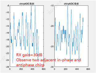

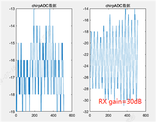

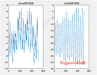

    Of course, I have capture raw adc data in same environment using 1432BSD EVM at office desk toward ceiling. In this test, to obtain the results more obviously, I set RX gain to 30 and 40 dB. Both results are shown as below, which I capture two adjacent in-phase and anti-phase chirps in both bin data, choose the same doppler bin and Rx channel, and I notice that the amplitude in each frames is similar. The profile I use are both the same simple chirp configuration without frequency hopping, enable fecRfBootCal and fecRfRuntimeCal.

    Since the DC value is significant, and your target is not corner reflector, it will be harder to compare the two ADC curves of different RX gains.   However, I can still see a major difference between the signal swing.  For example, the swing for 40dB gain is 45 and 35; and the swing for 30dB gain is around 18 and 12.   It may be more obvious if you look at the range FFT output.
    The ADC output is 12 bits output for xWRL1432, but 16 bits for 2944.   So, there will be at least 4 bits different in signal scale.
    Zigang

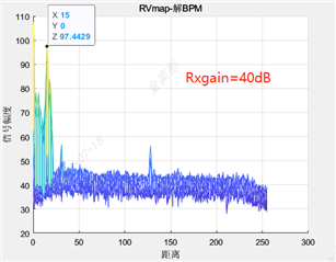

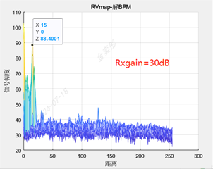

    As you mentioned, I tested the 10dBsm corner reflector of 5.5m in chamber, and the changes of Rxgain can be seen from the amplitude of the noise and peak value, but the time domain amplitude is not obvious. Can you come to a conclusion base on these results:  the configuration of Rxgain is effective?
    In addition, Is time domain amplitude such small, in TI 1432 BSD EVM test? I think the target has been calculated as a close strong target, but completely can not reach close to 12bits.

    Your new data clearly shows the configuration of Rx Gain is effective.
