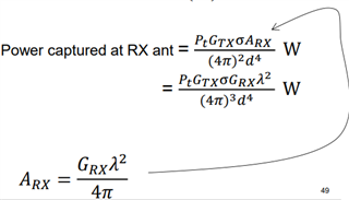

I am calculating Pr for a corner reflector with rcs 10 m2.

Pr what i am getting is -66.801 dBFS which is far from the fft output.What could be the reason behind it?
 I am using this formula for calculation.
I have doubt regarding the value of Gr, Gt values. Where to get these values for awr2243?
  what i did is, take value from this graph as 10.85 db for both antenna gain.Please correct me if i am wrong.
Also after post processing the Rx gain that is showing is 94 db.(I have kept it as 30db in chirp config which can be seen in above fig)
How is it even possible when what max Rx gain possible for awr2243 radar is 52db as mentioned in data sheet.

  • Hi Ajit,
    I went through the same calculation with your parameters and my theoretical received power comes to ~-45 dBFS which is very close to your measurement. A couple of points I would like to highlight is the rxGain measurement (94) that is shown in the studio should not be in dB. This number is in decimal and it is the addition of Rx gain and RF gain target in binary. In this case, if we add (0001 1110)+(0100 0000) = (0101 1110)-> (94). To understand this in detail, you could refer to the Interface Control Document, search for "PF_RX_GAIN".
    Second point is, when we are calculating for the received power, we also need to consider additional loss due to antenna transition loss. In addition to that, if you are looking at real data, there is a 13 dBm conversion factor that you will need to account in your calculation. Please refer to the following link to read more about it /cfs-file/__key/communityserver-discussions-components-files/1023/RadarStudio_5F00_matlab_5F00_scaling-_2800_2_2900_.pdf
    It might take some experimentation to get the right angle of elevation. Please refer to the following parameters I used to calculate the power in the following table.

    Thanks for doing the calculations. I have doubt regarding the value of Gt and Gr as in mmWave sensing estimator the values taken by default is 7 db(see fig below).
    And i have taken the Gt as 10.85 dbi from the AWR2243 userguide.
    So which value is to be taken as Gt and Gr, please provide an explanation if any.
    Also regarding the calculations you did, can you please share the exact formula like where to use the ant loss value -4db.
    Because from the formula i am using i still get -57.7234206693 dbm.
    1.68911e-9 after linear calculation, then i convert it to dbm.
    Also while substituting the rcs value in formula we put it in m2 right?(correct me if wrong).
    Ajit
  • Hi Ajit,
    I am following up internally on the 7dB that is fixed in the calculator so please give me some time to get back to you on that. Please use the 10.85dB from the HFSS simulation and that is what I used in the calculation.
    Regarding your question on 4dB loss, there is not a specific equation, and this is just an approximation for package to antenna transition and PCB loss that we account for. Typically, we add 1.5dB-2dB of loss each way, so that is where the 4dB is coming from.
    That is correct, the RCS would be 10 square meters. Please check the numbers in the linear value calculations or type it here so I can compare your values in the equation.

  • Hi Aydin,
    I am sharing you the matlab  code for Pr calculation and the studio output is Pr = -47.487 dBFS.

    The formula which i got from trail and error method that leads to studio output is
    Pr_dBm = 10 * log10(Pr) + Rx;
    dBmTodBFs_conversion = 13 ;
    Pr_dBFS = Pr_dBm + dBmTodBFs_conversion - 4; %here 4 is compensated for antenna loss
    So the output from this comes out to b e -47.53 which matches with studio output. But here the dbm to dbfs conversion needed to be subtracted right instead of that i added the same and got the correct answer.
    What may be the reason for this?
    Rectify any part of this code and if possible please give an explanation for the same.

  • Hi Ajit,
    I edited the code you could check it in the bottom. Distance in the measurement shows less then 4 meters, so changed the range to about 3.4m. Please note that the -4dB antenna loss should be multiplied in your main received power calculation as shown in below to account for the loss. In addition, when converting from dBm to Watts, there should be a factor of 1mW in the denominator which I did not find and added it the main power equation. Finally, you will need to add the receiver gain back while subtracting the conversion factor, line 32.

    The output from this code is Received Power (linear): 6.716062e-07 W
    Received Power (dBm): -61.728853 dBm
    Received Power (dBFS): -44.728853 dBFS

  • Ajit,
    Regarding the 7dBi antenna gain shown in the estimator, I've confirmed this is an error from the estimator and we are working to fix it. The correct plot is the HFSS simulation of the antenna pattern as you have attached, and it is found in the user's guide.

  • Hi Aydin,
    Pt = 10^((Pt_dBm - 30) / 10); % Convert dBm to Watts
    This is the conversion from dbm to watt, here 30 is compensated for the milliwatt right?
    So, still do we need to multifply 1000 in the denominator?
    Ajit
  • Hello Ajit,
    A correction here, I am not sure why you were subtracting 30. That expression should be divided by 1000 to get the answer in Watts. When calculating the Received power, we want the answer to be in mW for simplicity of converting back to dBm if it makes sense. Please check the following edit.
