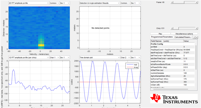

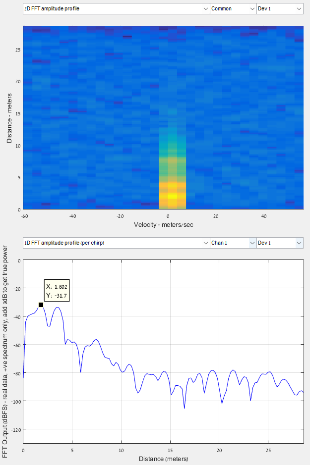

Enclosed is an image (screenshot from mmwave studio 3) displaying a measurement of 21.78dBsm corner, 1.8 meters distant from the radar.
Below, you'll find a Python code containing all parameters pertinent to the chirp configuration.
The image reveals a detection of -31.7dBFS at the corner, a deviation from the anticipated theoretical value of -7.6dBFS.
Although the user guide specifies an antenna gain of 15dBi, this value isn't evident in the measured outcome.
Your assistance in resolving this matter is greatly appreciated.

Result:
Pr = 2.4 [dBm] OR -7.6 [dBFS]
Python code:

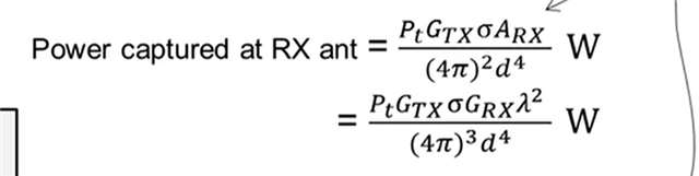

  • Hello Shlomi,
    Your formula is:
    Pr_lin = Pt * Gt * Gr * lambda_m**2 * sigma / ( (4*np.pi)**3 * R_m**4 ) * RX_gain
    from the video I mentioned, the correct formula for the power captured by the RX antenna is:
    i.e.
    Pr_lin = (Pt * Gt * sigma * Grx * lambda**2)/((4*np.pi)**3 * R_m**4)
    Which looks the same as your formula, except for the Rx_gain, so your formula is after the receiver, while the formula from the video is before the receiver.

    I conducted another experiment using the same corner (see image below), with a 23.96dBsm (the gain was accurately ensured by AWR6483AOP).
    According to the received power formula, the expected value is -3.32dBFS, whereas the measured value is -27.59dBFS. This indicates a disparity of about 24dB, which is 8dB higher than your observed difference.
    How can you explain this?

  • Hello Shlomi,
    After consulting with our team some more, we have found the following:
    1. there is about 2 dB of additional package loss to the antenna (so you need to account for 4 dB on a full TX to RX capture)
    2. if you are looking at real only you should use a conversion factor of 13 dB, not 10.
    3. the elevation beamwidth is very very narrow.  you may need to experiment to make sure you get the right angle of elevation.
    After accounting for these, we got a measurement in our chamber that was only 2 dB away from the theoretical value. see attached. DBFS CALCULATOR.xlsx
