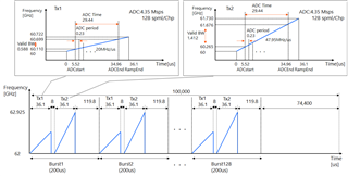

I want to change the chirp parameters of Tx1 and Tx2 and transmit in TDM mode.
I was considering using Tx0 EnableSel and Tx1EnableSel in mmWaveStudio 4.1.0.6 to achieve this.
To generate a chirp similar to the one shown in the diagram, is this configuration correct?

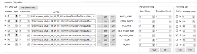

    Step1.Prepare seven files for PER_CHIRP_PARAM:
    ADC_START_TIME 16
    1590
    1590
    FREQ_SLOPE 16
    02BB
    068C
    FREQ_START 32
    0007CFC9
    0007CFC9
    IDLE_TIME 16
    1590
    1590
    TX_BPM 4
    0
    0
    TX_EN 4
    1
    2
    TX_START_TIME 16
    0000
    0000
    Step2.Run the following commands in the Lua file:
    xw_status = mws.sensPerChirpLut(0,0,1,"..\PerChirpLut\adc_start_time.txt")
    xw_status = mws.sensPerChirpLut(0,0,1,"..\PerChirpLut\freq_slope.txt")
    xw_status = mws.sensPerChirpLut(0,0,1,"..\PerChirpLut\freq_start.txt")
    xw_status = mws.sensPerChirpLut(0,0,1,"..\PerChirpLut\idle_time.txt")
    xw_status = mws.sensPerChirpLut(0,0,1,"..\PerChirpLut\tx_bpm.txt")
    xw_status = mws.sensPerChirpLut(0,0,1,"..\PerChirpLut\tx_en.txt")
    xw_status = mws.sensPerChirpLut(0,0,1,"..\PerChirpLut\tx_start_time.txt")
  • HI, there:
    I have never done that myself. Please give me some time to find the answer.
    Zigang
  • HI, there:

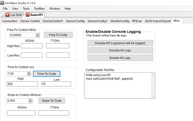

    1) First will need to reprogram the LUT entry based on your setup.  You can use the misc Tab in the mmwave studio to help.  And you need to make sure what resolution you were programming.
    2) You will need to program all the following command including perChirpLUT, perChirpConfig and perChirpCtrl.  I assume you only have two chirps, so I modify the len of array to 2 for you in per-chirp config
    3) For BPM configure, please let me know what you want to program, so that I can check the configure for you as well.  For example: chirp1: TX0 - TX1, chirp2: TX0 + TX1.   The tx_en and tx_bpm is little tricking.  One element contains information for two chirps.
