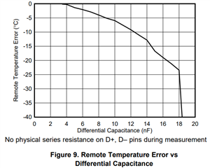

  • 1. TruTherm is for embedded junctions, and does not apply to your application with 3904 transistors
    2. The behavior of the analog front end changes.
    3. Excessive capacitance will create excessive negative temperature error, as seen in this plot from TMP468 datasheet. The LM95233 architecture is different than TMP468. LM95233 datasheet charts don't show the failure point for excessive capacitance, so we can't see the same effect. This error will occur on all remote sensors due to inability to settle before ADC sampling.
    4. Both contribute to settling time. Your CAD tools may be able to calculate trace capacitance. It will vary somewhat based on materials used.
    ren
