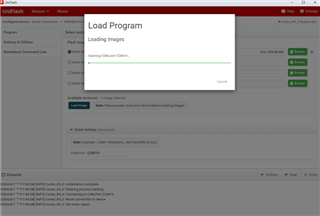

I purchased the MMAVEICBOOST and attempted to use UniFlash to program the firmware to the IWR6843ISK-ODS according to the user guide, but I have been unable to successfully flash it.
It often gets stuck at the following screen:

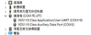

  3. COM port is recognized and using the COM19 of the Data port
