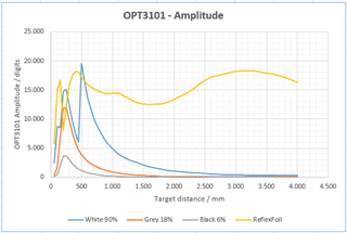

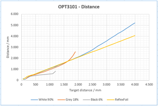

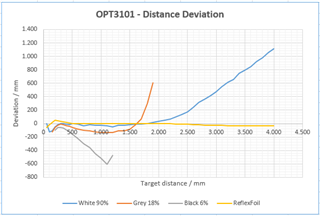

  • Hello Wenjuan,
    we tested more than 20 parts now.
    Our system is similar to OPT3101 EVM. We used the ConfiguratorTool (Super-HDR-Mode) and did all the calibration according to the user guide "How to set up and calibrate OPT3101 based systems for proximity sensing", with the help of the SDK.
    Following some measure data. It can be seen, that there is a distance deviation between the different targets, especially when the signal amplitude is getting smaller.
    Thank you.
    Stefan

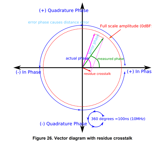

  • Hi Stefan,
    After calibration, what is the amplitude with the photodiode covered? The uncorrected non-zero amplitude after calibration is considered as residue crosstalk and it is crucial to determine the absolute accuracy of the system.
    As distance increases, the received signal amplitude reduces, so same level of crosstalk error will result in higher distance error.
    What LED and PD do you use? How does it compare against the OPT3101ESTIMATOR-SW Simulation tool | TI.com for similar conditions?

  • Hello Wenjuan,
    We observe the same issue on all parts.
    We use PD SFH2400 and a red light TOPLED LED.
    Thank you for your hint at residue crosstalk and the Estimator Tool.
    The simulation more or less corresponds to our system.
    The residue crosstalk varies in the range 0...400, with a strong temperature drift. So I think this is an issue of temperature deviation / compensation.

  • Stefan
    Crosstalk of 400 is high - do you only see the high crosstalk when there is a fast temperature change such as power reset or LED current switching as you discussed in temperature deviation / compensation? Did you have any change after all calibrations?
    Figure 26 in document "Introduction to Time-of-Flight Long Range Proximity and Distance Sensor System Design" described the residue crosstalk impact on distance error. Positive or negative depends how the residue crosstalk vector line up and there is no mechanism to determine the sign.
