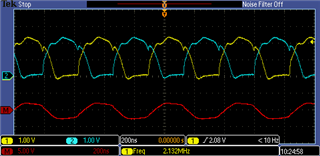

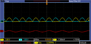

Here is the LC tank + sensors signal without buffers activated:

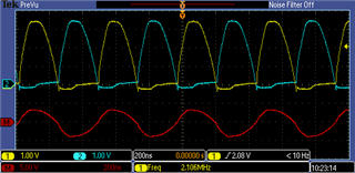

And here it is with the buffers on (no change to drive strength register):
Here are the outputs of the buffers:

    1. With the buffers inputs connected to the sensor, but the buffer outputs not connected to the shield, the sensor waveforms look okay?
    2. If the buffer outputs are then connected to the shields, the signals become tool large & distorted?

    1. Correct.
    2. Correct.

    1. STM TSV791ILT
    2. 50MHz, 30V/us. The datasheet mentions that 22 Ω on the output is "sufficient to make the TSV79x stable whatever the capacitive load." Which we tried, but it did not help.
    However, we changed to a buffer IC (BUF602) and ended up with 100 Ω on the output of that to finally make a stable shield and resonator on the FDC.
