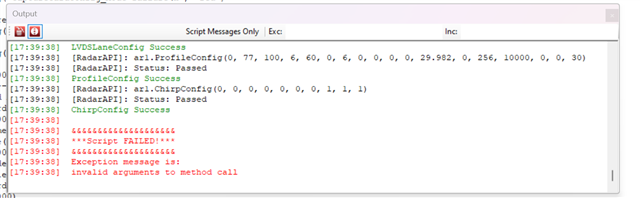

IWR1843BOOST: Problem with beamsteering using lua script
Part Number: IWR1843BOOST
Other Parts Discussed in Thread: IWR6843, IWR1843
I wanted to try TX based beemsteering with the IWR1843BOOST EVM to boost the SNR of detected objects at higher ranges,
I was able to manually steer at specific angles thanks to the calculator by the TI team but when I tried the automated lua script to use frame based beamsteering, I am getting this error every time. I have used the following script

    Your frame config is missing a 0. Which gives the error that the arguments are invalid for that method call since there are not enough of them. Should be like below.
    Use DataCaptureDemo_xWR.lua as a reference which can be found in C:\ti\mmwave_studio_02_01_01_00\mmWaveStudio\Scripts
    Pedrhom
  • Thanks a lot Pedrhom, I really appreciate the speedy response. If you don't mind me asking another question (Please bear with me as I am just an undergrad with not a lot of RF background)
    So I understood how the Frame based beam-steering works ( All the chirps in a frame are configured to steer at the beam at the same angle). Now I was wondering if I wanted to have beams at different angles in the same frame so that each chirp in the frame has a differently shifted TX phases to project the beam at different angles like say by increments of 5 degrees.
