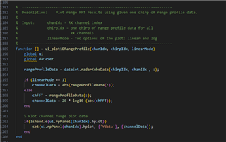

For that I used the Matlab code named rawdatareader  stored in "C:\ti\mmwave_studio_03_00_00_14\mmWaveStudio\MatlabExamples\singlechip_raw_data_reader_example\rawDataReader.m" and got the 2 files named Radarcube and adcdata. What is the significance of adcdata file?
For the Radarcube data, I am unable to understand what type of data is stored inside the radarcube.data file. Is it the FFT signal or the raw data captured? When I open it in matlab I get 8 columns of 128*4*256 complex single numbers.
I tried to read the mmwave studio userguide to understand the data and I was not able to properly understand this.
As far as I understood, the data stored in radarcube.data contains three-dimensional array of size SamplesPerChirp * NumRecievers * NumChirps.
I want to know if these data produced after using the script named rawdatareader is already FFT data or I have to do FFT on each of these data stored in the radarcube.data.(if so then how?)
I was also trying to do FFT on these data, but I got complex number after applying FFT on complex data but the FFT graph shown in the plot after using the mmwave studio was real.
I also wanted to know about where can I get the timestamps for the obtained data.
Is there any script/matlab code to produce the FFT data directly from the adc_data.bin. If so then please share.
Also please help me on how to get FFT data from each chirp of 8 frames just like we obtain in the mmwave studio.

  • Hi Niladri,
    This *.mat file has the raw ADC data stored in it.
    Yes, radarcube has the 1D FFT not the raw ADC data.
    1D FFT of each frame is stored in each column.
    Please go through rawDataReader.m to understand what is being done and how is 1D FFT computed.

  • Hi Niladri,
    rawDataReader.m file has the code to plot 1D FFT. I suggest you to go through the MATLAB script and understand what is being done.

  • Hi Niladri,
    You can refer to mmwave_studio_03_00_00_14\mmWaveStudio\MatlabExamples\4chip_cascade_MIMO_example. We do not have MATLAB scripts for single chip that performs 2D FFT and angle estimation.
