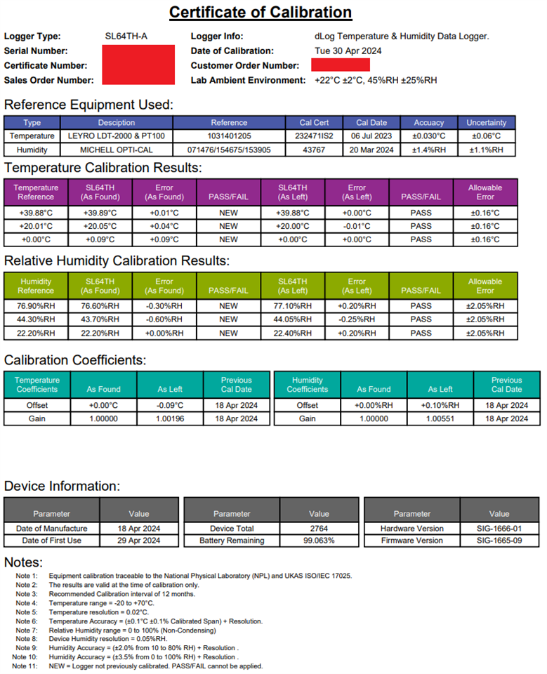

    Below is a product with the HDC3021 which was shipped to a customer in April 2024, the stock had only arrived weeks earlier. The humidity was very accurate without any adjustments.
