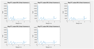

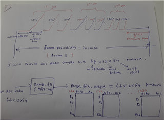

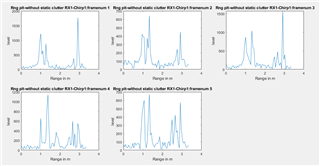

    i have captured ADC data using AWR6843ISK+DCA 1000 card for the following Chirp design parameter and trying to implement capon beam forming as per the equation used by you:
    system parameter:
    Maximum range - 2.7 m
    Range resolution - 0.053 m
    Maximum velocity - 0.406 m/s
    velocity resolution - 0.015 m/s
    chirp design 1:
    profileCfg 0 60 943 11 41 0 0 97 1 64 2200 0 0 30
    channelCfg 15 7 0
    adcbufCfg -1 0 1 1 1
    chirpCfg 0 0 0 0 0 0 0 1
    chirpCfg 1 1 0 0 0 0 0 2
    chirpCfg 2 2 0 0 0 0 0 4
    frameCfg 0 2 54 0 200 1 0
    antenna pattern attached for your reference:

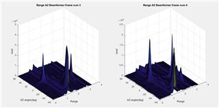

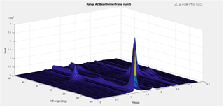

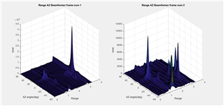

    I have used the same capon beamforming equation  and calculating Range_Azimuth spectrum .(step by step calculation screenshots attached below for your  reference):
    My question:
      1. please check and confirm the above steps, am i calculating range-azimuth spectrum correctly or is there any mistake in my calculation?
    regards,
    Mani

  • HI, Mani:
    Your diagram looks good to me.  Let me know if you experience any difficulty that make you doubt your implementation.
    Zigang

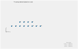

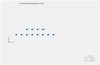

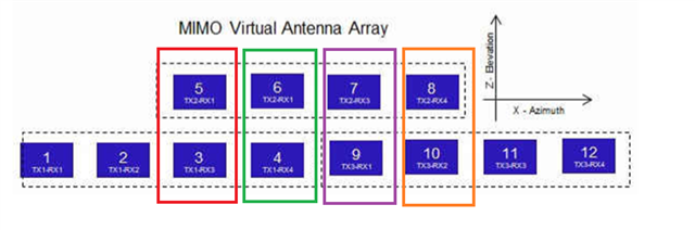

      i have attached AWR6843ISK card antenna pattern for your details
    i have captured real time data using AWR6843ISK + DCA 1000 card for the followings two  test cases of antenna Transmission order.
    for both test cases ,Virtual antenna used and antenna elements positions used to generate steering vector(which is used part of Capon beam forming )also shared for your reference.
    Case 1:
           Chirps are transmitted using following TX antenna:
                            Chirp1 - TX1
                            Chirp2 - TX2
                            Chirp3 - TX3
                  (the same way chirps are repeated in the remaining active chirp transmission time )
    I have attached  virtual array generated and used inside my code:
    Virtual array element positions:
    Antenna elements used for capon beamforming:
    Sno
    Antenna elements used for Rng-AZ capon beam forming
    Antenna elements used for Elevation capon beam forming
    1
    [1,2,3,4,9,10,11,12]
    [1,2,3,4,5,6,7,8,9,10,11,12]
    Case 2:
                            Chirp1 - TX1
                            Chirp2 -TX3
                            Chirp3 -TX2
    Sno
    1
    [1,2,3,4,5,6,7,8]
    my question:
     please check and confirm me, whether Antenna elements chosen for capon beamforming(Both Rng-azimuth and elevation) are correct for both test cases 1 and 2?
    regards,
    mani
    Thanks for posting. This is a holiday week in the U.S. We will follow up early next week.
    Clinton

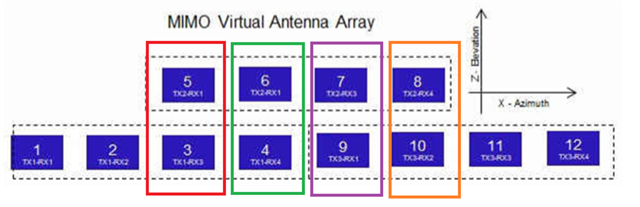

  • HI, Mani:
    If you are using 1D azimuth capon beamforming, all the antenna used has to be with the same elevation index.
    If you are using 1D elevation capon beamforming, all the antenna used has to be with the same azimuth index.
    Based on the above rule, the antenna elements you used for rng-azi is correct.  The antenna elements you used for rng-elev is incorrect.  Based on the figure below, you can use (3, 5) or (4, 6), or (9, 7) or (10, 8), i.e., you can use any of the these four sets to calculate the rng-elev beamforming.   At the end, you can sum them in power to the get the rng-elev angle spectrum in power.   Let me know if it is helpful.
    Zigang

    I have calculated elevation capon beamforming using the same capon equation, elevation antenna element selected as you suggested  and generated  corresponding elevation spectrum .(step by step calculation screenshots attached below for your  reference)
    Steering vector calculation for chosen elevation antennas (steps by step calculation screenshots also attached for your  reference):
    my question:
    1. please check the above  both "elevation capon beam forming  and  steering vector generation for elevation antenna chosen"  screenshot and confirm me, whether am i estimating correctly or any error in the flow?
    2. your previous reply"The antenna elements you used for rng-elev is incorrect.  Based on the figure below, you can use (3, 5) or (4, 6), or (9, 7) or (10, 8), i.e., you can use any of the these four sets to calculate the rng-elev beamforming.   At the end, you can sum them in power to the get the rng-elev angle spectrum in power"
        i did not understand the meaning of "At the end, you can sum them in power to the get the rng-elev angle spectrum in power. ",can you explain me detail or  better  way?
    mani
  • Hi, Mani:
    1) Sorry, we can not reviewing your algorithm in detail.
    2) Sorry for the misunderstanding.  Since you are trying to calculate the peak from range-azimuth spectrum. Giving the peak (rng_peak, azi_peak), you calculate the elevation spectrum.  If that is the case, then you could use all the antennas, because the azimuth angle is known in this case.
    Please ignore my previous comments.  I thought you are trying to calculate range-elevation heatmap without knowing the azimuth angle.
    Zigang

  • Hi, Mani:
    I just realized that although the TIDEP-01023 is no longer supported, the people counting demo still support this mode (2D range-azimuth heatmap -> peak detection -> elevation 1D heatmap).
    1)   "If that is the case, then you could use all the antennas, because the azimuth angle is known in this case." please confirm are you referring which of the below all antenna numbers and orders?
    [ZY]  the algorithm uses all  antennas for elevation capon beam forming  = [ 1  2  3  4  5  6  7  8  9  10 11 12 ], and the covariance matrix and its inversion is calculated using all 12 antennas.  Regarding the antenna order, as long as the order matches the steering vector generation order, it will be fine.
    2)   In case i m trying to calculate range-elevation heatmap from range FFT output  as first step itself without knowing/using the azimuth angle.
    Based on the above rule, the antenna elements you used for rng-azi is correct.  The antenna elements you used for rng-elev is incorrect.  Based on the figure below, you can use (3, 5) or (4, 6), or (9, 7) or (10, 8), i.e., you can use any of the these four sets to calculate the rng-elev beamforming.   At the end, you can sum them in power to the get the rng-elev angle spectrum in power.  "
    I could not understand "At the end, you can sum them in power to the get the rng-elev angle spectrum in power.  " Can you explain it?
    [ZY] Combine the spectrum in power is not optimal.  We have done this way when using Bartlett beamforming.  Consider θ is azimuth angle and ∅ is elevation angle.  The Bartlett 2D beamforming can be calculated as below.
    If you just picked the antennas with a common m_i, and different n_j,  the phase offset (m_i * sin⁡θ  * cos⁡ϕ) is common.  When you calculate the spectrum in power, this phase offset can be ignored.   For ISK board, you can choose any 4 options below for this spectrum calculation (within the set, they all have common azimuth index m_i) .   And you can also add the spectrum in power to get some non-coherent gain.   But I am not sure whether it makes sense to combine the spectrum when using capon beamforming.  Hope it is helpful.  Given that the ISK board have two element in elevation direction, it does not make sense to start with range-elevation heatmap calculation.
    Zigang

    I am also using the following order to estimate range,azimuth and elevation information .
    (Range FFT->2D range-azimuth heatmap -> peak detection -> elevation 1D heatmap).And followed reference equation and  step by step flow explained part to TI design documents.
    And I have tested  implemented chain with real time adc level data (logged using dca+ AWR6843ISK) but not getting expected results at capon rng_Az beamforming and so i want to get fix the issues.
    Please confirm whether I can share the test results snapshots part of this thread pr need to create a new thread..so I will do accordingly .

    Antenna elements used for Rng-AZ capon beam forming : [1,2,3,4,9,10,11,12]

    Adc raw data   ----> Range FFT->static clutter removal ---->2D range-azimuth heatmap
    (as shared in previous replies,an algorithm implementation flow are done same as TI reference design document equation and step by step flow)
    i have attached screenshots of results at each stage for the first 5 frames data(out of 300 frames captured) for your reference:

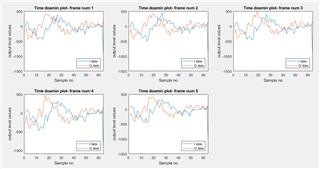

    1.I & q sample data:
    2. Range FFT output of RX antenna 1 and chirp no:1:
    3. Range FFT output after static clutter removal:
    4.Capon beamforming Rng-AZ heat map:
    my question:
    1.why am i getting varying peaks on each frame  at different ranges on the Rng-az capon beamforming (not consist with targets presents in scenario)? if any mistake in the implementation steps ,please let me know
    regards,
    mani

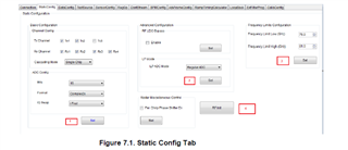

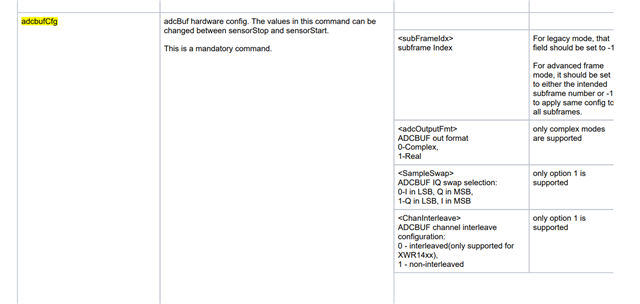

    SDK OOB demo does not support real ADC mode.  You can find it in the SDK users guide.
    You can only do real ADC data capture through mmwave studio.
    Zigang
  • hi zigang,
    thanks for your reply.
    The captured ADC data is for complex 1X only  not for real ADC data.
    mmwavestudio supports  capturing of  three different mode of ADC data " real ","complex  1X","complex 2X".(screenshot is attached).
    kindly check and let me know "1.why am i getting varying peaks on each frame  at different ranges on the Rng-az capon beamforming (not consist with targets presents in scenario)? if any mistake in the implementation steps ?
    regards,

  • HI, Mani:

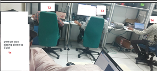

    You have such a cluttered area.  There are several people working on the back.  To start with, I would suggest you to set up on a cleaner environment and with only one person walking in the field of view. And then you can check whether the heatmap change makes sense.
    Zigang
