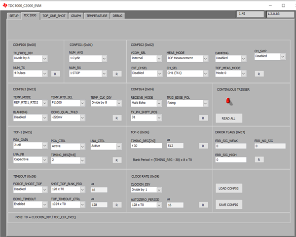

  • GUI Configuration:
    In the GUI, I have tried the following settings:
    • Clock Divider: 32
    • NUM_TX Pulse: 4
    • PGA Gain: 21 dB
  • Observed ToF:
    With the above settings, the ToF value I am seeing in the GUI is around 59 µs.

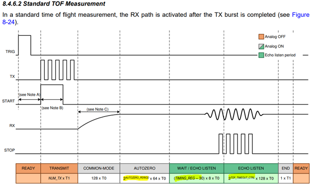

    Did you change the clock that is on the TDC1000-C2000EVM? The reason I ask is because the transducer you provided has a resonant frequency of 400kHz while the signal you may be providing is at 250kHz.
    The reason you keep triggering getting at a fixed ToF of 59us is probably because the timing windows have not be configured properly on the device. Meaning that the device is listening for an echo much earlier than it should be so you are probably triggering on the noise of the excitation pulse as the signal ramps down.. You can configure the correct listening window by using the expected speed of sound in the medium that you are measuring in. Here is a quick snapshot of the standard ToF mode. I included a capture of the standard ToF mode and highlighted some of the registers you would need to change the measurement periods. Keep in mind if you are using the short ToF method these registers would be different.

  • Hi Lara,
    I am attaching the Standard ToF measurement configuration in the GUI. Please check whether it is correct or not.
  • I am not getting accurate result.
  • Abhijit,
    This may not be correct, mainly due to the external clock. If you did not change to the external clock option you may be generating a 1MHz pulse on a 400kHz transducer, please make sure to provide an external clock on TP19 as well as changing the setting for JP1 on the hardware. You can also enter the correct clock value on the "Setup" so that the GUI reflects the correct values.
