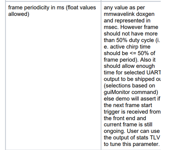

    You have:  frameCfg 0 2 16 0 1000 1 0
    Means the frame rate is 1000ms, which is 1s.  It should be long enough.
    Zigang
  • Shouldn't it be less than 1000ms? Since I have to capture data in short period, I think I should decrease it (e.g. 1000 -> 100 as shown in "IQDataStreaming.cfg).

  • I used this frameCfg variable
    frameCfg 0 2 16 0 100 1 0
    At first, it worked very well (with normal speed) but it couldn't read data from radar after 5-6 sec.

  • Hi, there:
    You are enable the heatmap transfer, that needs a lot of bandwidth.  Please remove those, and change to
    guiMonitor -1 1 0 0 0 0 0
    Please try again and let me know.
    Zigang
  • It works! Thank you so much!
