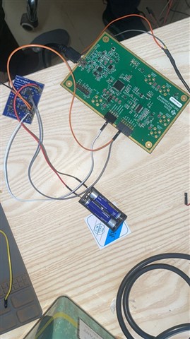

We developed an HV board based on the reference given (here) to boost the voltage and although the HV TX pin indicated the 30 V as expected (shown in the scope image), we were unable to receive the echo pulse.
With the GUI, we enabled the TDC1000-HV Driver EN1 after connecting the EVM to the HV circuit board.
With the same GUI settings, we receive an echo signal without the HV circuit board, but we don't receive it when use the HV circuit.
Do you have any advice on what to do to receive the echo signal?

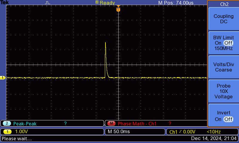

  • Hello Isaac,
    Here are the settings we had. We set a really high listening window
    When we zoomed in to the Tx pulses, this is what we observed. Our Transducer is 1MHz.
    We did some additional testing to identify where the signal gets lost along the received signal path (LNAOUT (R21), PGAOUT (R27), and at R30 which connects the COMPIN)
    The images below are shown in that order (
    LNAOUT (R21)
     PGAOUT (R27)
     COMPIN (R30)
    When we disconnected the HV, and tested the transducer without it, this is the signal at R30, which gives good results.
    What adjustments can we do to make sure that we get an echo signal when we use the HV?

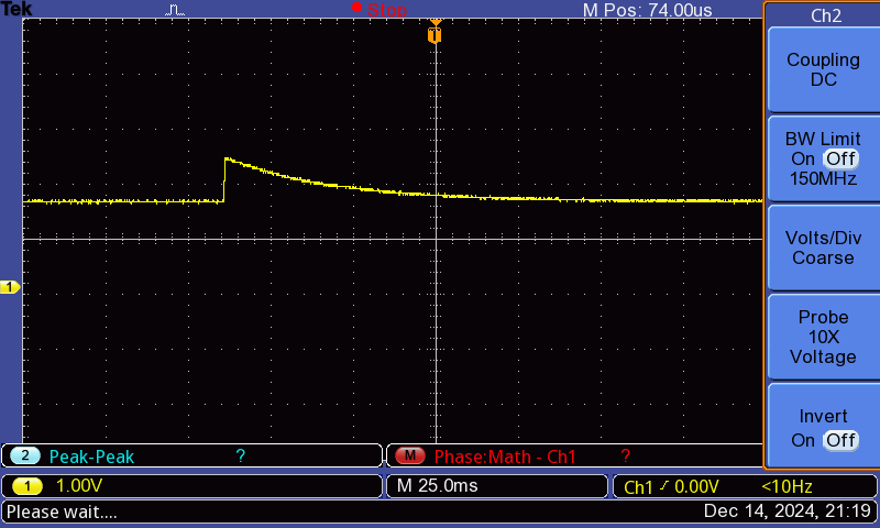

  • Semyalo,
    Can you try increasing the amount of pulses you are sending out and capture the waveform so that I can see what the signal looks like?
    Also I am not sure if your transducer is receiving any data. The LNA and PGA signals dont look like how we would expect them to look whenever they are getting data so my assumption would be that they are somehow now connected.
    A good way to test out your RX and TX is to test it out with another system and check if you are sending out data correctly as well as receiving data from the other system. My first thought is that perhaps the TX is not generating the pulses appropriately so if this is not sending out the transmission at the correct frequency this would explain why you are not getting anything back during the listening period. If you are transmitting properly then perhaps there is something that needs to be addressed on the RX portion.

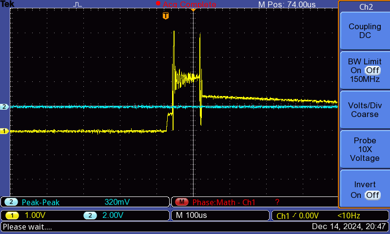

  • Hello Isaac,
    We have tested out the 500khz transducer (PSC500K018060H2AD2-B1) from Jiakang. We have also changed the hardware as advised, but looks like we can't have a signal get through the metallic cylinder. (we have tested it on a 22cm high metallic LPG cylinder)
    Below are our settings and scope image
    blue is Compin/echo, yellow is STOP pulse. Our target should be 446us
    Any more advice will be much appreciated!
    Semyalo
  • Hello Semyalo,
    The scope shot is a little too zoomed out can you try to zoom into the compin signal so that I can see what is going on?
    It would also be good to know what the time divisions on your scope are set to.
    Isaac
