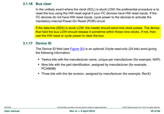

  • The TMP117 would not hold SDA indefinitely; it has the SMBus Timeout feature. It will abandon a transaction that takes longer than about 30ms. You normally wouldn't be able to observe this timeout behavior. If you began a transaction where TMP117 was addressed, such that it ACK'd, and then stopped providing clocks during the ACK pulse, you could see the TMP117 release SDA after 30ms.
    A strict I2C device supports an infinitely low clock rate, and could hold SDA forever if the transaction were stopped at the right moment. I don't see mention of the SMBus Timeout feature in the VCNL3040 datasheet, so it likely behaves this way. For an I2C device without timeout, the only way to get out of this SDA low condition is to send 9 clock pulses or reset/power-cycle. The nine clock pulses are mentioned in the official I2C spec under a section titled Bus clear.
