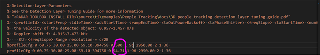

Expand the bandwidth via freqSlope, but it show the error message, "Debug: Init Calibration Status = 0xffe"
Does any suggestions about configuration modification?
Thanks.

profileCfg 0 60.75 30.00 25.00 59.10 394758 0 54.71 1 96 2950.00 2 1 36

Change the freqSlope in cfg file
