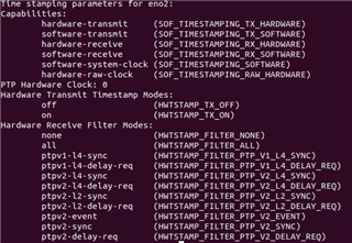

I have obtained ptp4l through cross-compilation, moved it to the MMWCAS-DSP-EVM, and the version is 1.92.
However,I am unable to achieve PTP time synchronization with the host.
1.Host Network  Card Support for PTP

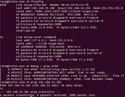

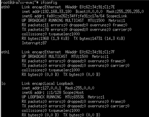

  • Hello Josue
    Thank you for your response. My current issue is that the CPSW eth0 on the MMWCAS-DSP-EVM running Linux cannot communicate with the host over the network. To configure a static IP, I modified /etc/systemd/network/10-eth.network, and I ensure that the IP address of eth0 on the MMWCAS-DSP-EVM is set to 192.168.33.180 after each reboot. However, I am unable to ping the host. Could you provide me with some suggestions?

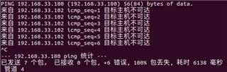

  • Hi Josue
    I don't have a router or switch. I just want to connect the MMWCAS-DSP-EVM to a PC using an Ethernet cable so that they can communicate within a local network. I have confirmed that the IP addresses are set within the same subnet and the physical network connection is fine, but I still cannot ping the PC.
