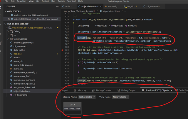

Good afternoon~ The question is as title.My IDE settings are as below :
IDE version : CCS 20.0.1
XDCtools : 3.50.8.24_core
SYS/BIOS : 6.73.0.01
mmWave SDK : 3.6.0.00-LTS
Project : out_of_box_6843_aop
Board : MMWAVEICBOOST + AWR6843AOP
Operation mode : debug
I have put  "#define DebugP_LOG_ENABLED 1" at the top of main.c
mmw.cfg is as below :

 * Enabling DebugP Log Support
var Log         = xdc.useModule('xdc.runtime.Log');
var Main        = xdc.useModule('xdc.runtime.Main');
var Diags       = xdc.useModule('xdc.runtime.Diags');
var LoggerBuf   = xdc.useModule('xdc.runtime.LoggerBuf');
/* Configure the Logger Buffer: */
var loggerBufParams             = new LoggerBuf.Params();
loggerBufParams.bufType         = LoggerBuf.BufType_CIRCULAR;
loggerBufParams.exitFlush       = false;
loggerBufParams.instance.name   = "_logInfo";
loggerBufParams.numEntries      = 200;
/* Create the Logger and attach this to the application */
MyAppLogger                     = LoggerBuf.create(loggerBufParams);
Main.common$.logger             = MyAppLogger;
Main.common$.diags_USER1        = Diags.RUNTIME_ON;
Task.common$.diags_USER1        = Diags.RUNTIME_ON;
I set up a breakpoint below the DebugP_log2 inside objectdetection.c and turn on the "RTOS Objects" in console
but see nothing (I expected to see "ObjDet DPC: Frame Start, frameIndx = %d, subFrameIndx = %d\n"objDetObj->stats.frameStartIntCounter, objDetObj->subFrameIndx)
Is there anything else I have to take care in order see the content of DebugP_log2 ?
