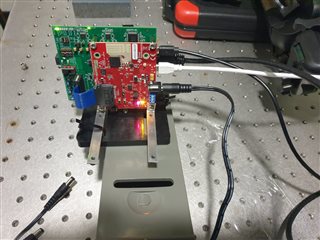

    I am attaching the screenshot of setup here:

  • Hi Niladri,
    There is a switch on the EVM board, S1, which I can't tell the direction from your image, but could you make sure that SPI is selected?
    Now to your second question, the maximum chirp bandwidth you could do is with VCO2 and that will be 5GHz. Please refer to "AWR_PROFILE_CONF_SB" API in the mmWave Interface Control Document (ICD), so you will need to design your chirp within this bandwidth.
    Please refer to the calculator within the mmWave_studio under (RampTimingCalculator) as there are other dependencies (There are also example calculations in the ICD document section12.4.1 Note on idle time for clearing the watchdog (WDT) explaining the chirp timing calculations).
    Aydin
  • Hi Aydin,
    Thanks for your message. From the troubleshooting that you told me I am now able to fix the TI Radar kit and this works now.
    Thanks very much.

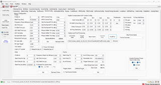

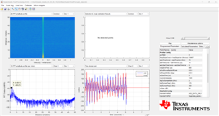

  • Hi Aydin,
    Thanks for your reply.
    I have a query regarding the chirp configuration.
    When I am configuring a chirp of 800 us time length or 1000 us, everytime I get data in the time domain plot upto 500 us and then no data.
    Is 500 us the ramp end time limit for the T-chirp?
    Please let me know.
    I am attaching the screenshot of the programmed chirp parameters and output graphs here below.
    Thanks and regards,
    Niladri
  • Hi Niladri,
    Please try reducing the sampling rate or reduce the number of RX channels and check, it could be due to data buffer.
    Aydin
