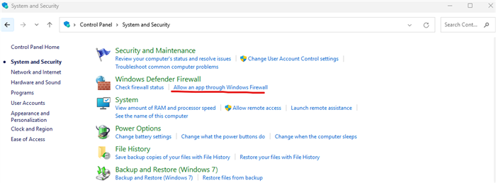

Hi Sensors team,
I get the following error when trying to connect to the DCA1000 EVM. "Timeout Error! System Disconnected"
After timing out a few times, I get this final error: "Unable to read FPGA Version. [error -5]"
What could be causing this issue?
  • Hi Ethan,
    This error is sometimes caused by issues with the Windows Firewall. Try navigating to Control Panel > System and Security, and click Allow an app through Windows Firewall.
    On this screen, make sure that all dca1000-related programs are allowed in Domain, Private, and Public:
    This error can have other causes as well. I'd recommend taking a look at the DCA1000 FAQ, section 6 for our most up-to-date troubleshooting recommendations.
