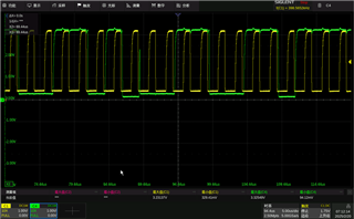

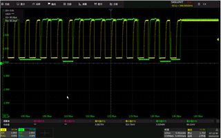

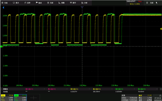

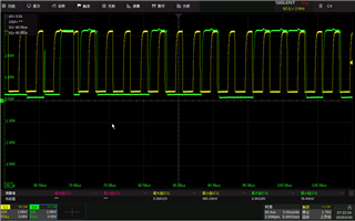

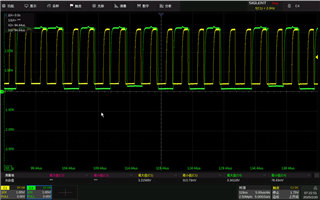

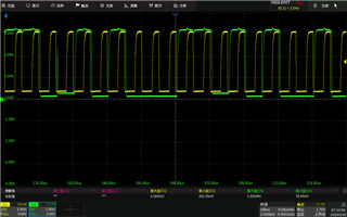

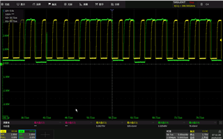

  • Sakeenah,
    // Below is Set High Alert 80% RH 60 degree  address0x611D  value0xCD33  CRC0xFD
    2E B2 04 00 3E 74 75 69 2D 6D 63 75 8A A4 00 61 1D 01 CD 33 FD 00 00 00 00 00 00 00 00 00 00 00 00 00 00 00 00 00 00 00 00 00 00 00 00 00 00 00 00 00 00 00 00 00 00 00 00 00 00 00 00 00 00 00 00 00 00
    Cmd return success:
    I2C capture:

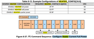

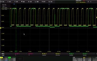

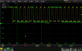

    // Below is Set Configure Heater Current Full Power  address0x306E  value0x3FFF  CRC0x06
    2E B2 04 00 3E 74 75 69 2D 6D 63 75 8A A4 00 30 6E 01 3F FF 06 00 00 00 00 00 00 00 00 00 00 00 00 00 00 00 00 00 00 00 00 00 00 00 00 00 00 00 00 00 00 00 00 00 00 00 00 00 00 00 00 00 00 00 00 00 00
    Cmd sent successful. But return I2C write Fail.
    I2C capture is :

  • Sakeenah,
    I add some note for I2C signal capture. I found their command Set Configure Heater Current Full Power is wrong. I let them check their code.
    Thanks for your support
