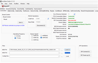

I am attempting to get an IWR1843BOOST with an ADC1000 up and running with mmWave Studio 2.1.1.0.  I have successfully loaded the demo BSS firmware as shown in the first screenshot.  However, when attempting to load the MSS firmware the system appears to lockup, as shown in the second screenshot.  One oddity that I noticed is that the BSS firmware is shown as 0.0.0.0 with a date of 00/00/00.  The BSS file loads reasonably quick.  The MSS stays stuck on 0% loaded for more than five minutes.  I have tried this twice now with the same results. Thoughts on how to troubleshoot this?
    Please check the DCA1000 E2E FAQ post for all information relating to the DCA1000. My guess is that the hardware switches/SOP modes may be incorrect for DCA1000 mode.

  • Here are the switch settings I have...
    IWR1843BOOST...
    SOP mode (debug/development mode).
    SOP0: Off
    SOP1: On
    SOP2: On
    S2:  SPI
    On the ADC1000...
    LVDS_MODE_SEL:
    16BIT_ON
    14BIT_OFF
    12BIT_OFF
    SW2...
    LVDS_CAPT:  OFF
    SD_STORE:   OFF
    1243_MODE:  OFF
    RAW_MODE:  OFF
    HW_CONFIG: ON
    USER_SW1: OFF
    USER_SW2: OFF
    USER_SW3: OFF
    Note: I did flash "mmwave_sdk_03_06_02_00-LTS\packages\ti\utils\ccsdebug\xwr18xx_ccsdebug.bin" which is something I believe is needed to utilize debug/development mode in order to load the rf_eval_firmware bss and mss files.  Should I be flashing something different?
    rf_eval_firmware bss and mss files would overwrite any .bin flashed to it prior. So although not used, having flashed xwr18xx_ccsdebug.bin should not have affected anything in theory. That said please check the photos for switches in this user guide. They are wrong based on what you have written

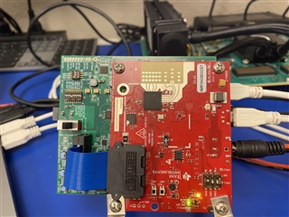

  • Per the DCA1000 mmWave Studio User Guide:  "Make sure your device’s SOP mode is in “Development” mode, which is where SOP0 and SOP1 are ON and SOP2 is OFF with regards to the mmWave sensor."  However, whenever I configure for this mode the NERR light illuminates (see "Debug Fails" picture) and I am not able to connect to the device via CCS.
    When I configure as follows: SOP0: OFF, SOP1: ON, SOP2: ON, the NERR light is off (see "Debug Good" picture) and I am able to connect via CCS and load and step through an application.
    I have seen this behavior even before adding the DCA1000 module to the 1843 EVM.

  • Hello Ron,
    Why are you trying to connect to the device via CCS when in Development/DCA1000 mode? When the radar sensor is set like this, the DCA1000 interfacing is what will be working. Ignoring the LED, are you able to connect in mmWaveStudio like this?
    Pedrhom
  • I am not trying to connect to the device via CCS when attempting to use the mmWaveStudio.  I am just trying to point out that there might be an issue with how the dip switch settings are documented.  The mmWaveStudio and CCS both seem to want development mode (which I assume is the same as debug mode) to have SP2: Off, SP1: On, SP0: On.  However, I have not been able to get debug to work with CCS with those dip switch settings.  The only way that I can get CCS to work with this device is with the dip switch settings SP2: On, SP1: On, SP0.  Wonder if this is an issue with Rev C of the board (which has dipswitches instead of jumpers)?
  • Noticed a typo in my message above. The second to the last sentence should read: The only way that I can get CCS to work with this device is with the dip switch settings SP2: On, SP1: On, SP0: Off.
    This makes sense, and I see where the problem is. The naming terminology here is definitely confusing since we are using "debug" twice but meaning two different things. CCS only needs the device in either functional or flashing mode to run CCS Debug for application code debug. Debug hardware configuration mode is for raw data capture and other front-end RF, chip level debug, aka DCA1000 + mmWaveStudio.
