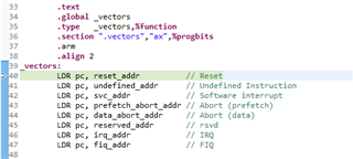

Hi
  I use CCS to raise a debug session in default AWR2944 OOB firmware, but it seems to block in HwiP_undefined_handle(). Can you please help to check the reason?
Radar board: AWR2944 Evaluation Module
radar toolbox version: v2_30_00_12
example: source\ti\examples\Out_Of_Box_Demo\src\awr294x
Target Configuation file:
AWR2944.zip
Thanks.

  • Hi Shruti,
      I rebuild OOB firmware source to TDM MIMO,  flash it via UniFlash, and set up a debug session in CCS. I got this problem.
    In CCS part, connect to target and loading these program.
    Coretex_R5_0: loading out_of_box_2944_mss.xer5f
    C66xx_DSP: loading out_of_box_2944_dss.xe66
    Thanks.

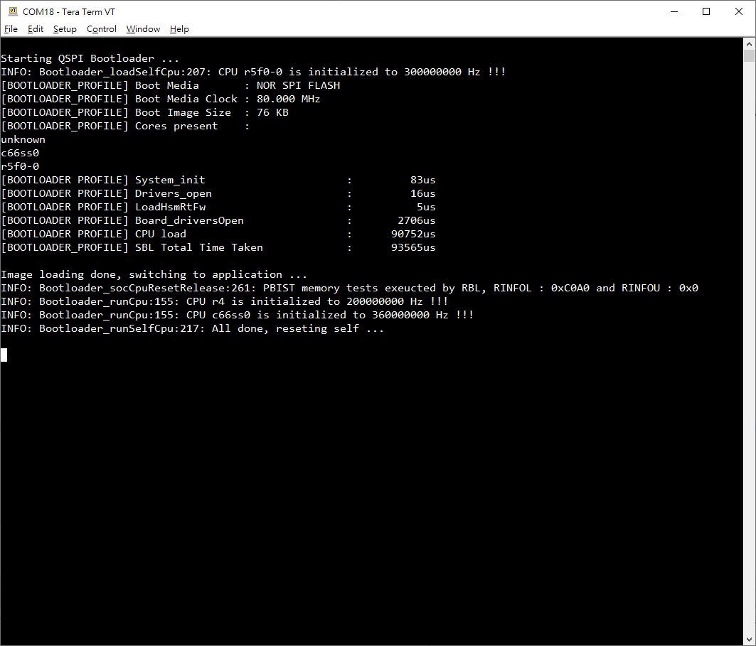

  • Hi Shruti,
     Follow SDK user guide section 3.3.2 , I saw this screen and I can't input any radar configurations. Please help to check it.
    Screenshot in Teraterm
    Screenshot in CCS
    Thanks.

    What is the baud rate that you have set for your UART terminal? Can you check in sop5 mode what response you are getting here after pressing the reset?
    Ideally you should get the prompts here. The flashing logs that you have shared also doesn't look correct, you should get the ccsdebug image loading prompt as well.
    Shruti
  • Hi Shruti,
    The baud rate settings is as below:
    Command UART: 115200
    Data UART: 3125000
    ==> It's the flashing log. It's show "Program Load completed successfully" in UniFlash console. Can you point out why you think it's not correct?

    After press NRST key in functional mode, it will show this information in teraterm. But I still can't input any radar configuration.
    After press NRST key in flashing mode, it will show this information in teraterm.
