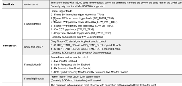

Secondly, I´ve used Putty to manually configure TX/RX and I could execute channelCfg, chirpComnCfg, chirpTimingCfg, and frameCfg commands without errors. However, when I run sensorStart, I always get the following error:
mmwDemo:/>sensorStart 1 0 0 0
Error: mmWave Config failed [Error code: -3108 Subsystem: 0]
Done
I also tried resetting the sensor with sensorWarmRst 0, but the same error appears.

  • Hi, Joao:
    It is possible to synchronize two EVM board, one can be programmed as master and the other one can be programmed as slave mode.  The frame start signal of the master board can be used to trigger the frame start in the slave board.   And you can program the trigger mode and program the trigger delay to synchronize them.  But as mentioned below, this part of the function has not been tested.   At the same time, you need to change the board to feed the frame start signal from master board to the slave board.
    On the other hand, unless the two devices share the same clock, you will not be able to get perfect received signal like the single device case.  The devices on our cascade board will have perfect synchronization.
    Zigang
