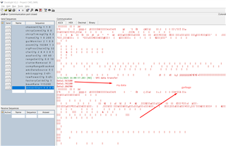

2. UART Garbage Data Issue
After configuring the device through the serial monitor (including setting LowpowerCfg 0), I use the cli_write function to send data to the serial monitor. While I receive the expected output, there is additional garbage data appearing. How can I avoid this? I have attached a screenshot for reference.

    Please find my corresponding thoughts for your questions.
    1: I suggest you to run the power example present in the sdk first and also look at the readme file present in sdk directory for further information.
    2:, did you try mmwUartWrite function? What type of data are you sending and where are you configuring this in the code?

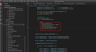

  • Hello Sharan,
    I reviewed both threads, and they appear to be addressing the same question. However, I couldn't find a clear solution.
    Could you please provide guidance on enabling LPDS and waking up the device using UART? Your insights would be highly valuable for me and others facing similar issues.
    For now, I would like to implement wake-up using the system clock. To achieve this, I have ported a few lines of power example code into my level sensing application. However, I haven’t observed any power variation, and the system consistently remains in the power_none state. I will attach the relevant code for your reference
    What modifications do I need to make to enter LPDS using the System Counter, and how can I wake up using the System Counter? I have referred to the example code—what specific code should I port, and what changes should I make in the entry hook and resume hook functions?
    Additionally, should I select the "Enable Policy" option in the Power System settings within the SysConfig file?
