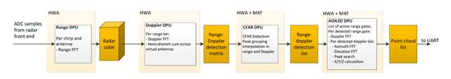

  • Hi, there:
    For BPM demodulation, there are two methods implemented in SDK L demos.
    1) in the motion and presence detection demo, the BPM demodulation is done at range FFT as shown in the Doxygen documentation (file:///C:/ti/MMWAVE_L_SDK_05_04_00_01/docs/api_guide_xwrL64xx/MOTION_AND_PRESENCE_DETECTION_DEMO.html).
    2) in the mmwave_demo, the BPM demodulation is done at AoA2D DPU.  As explains in the SDK L Doxygen documentation at:  file:///C:/ti/MMWAVE_L_SDK_05_04_00_01/docs/api_guide_xwrL64xx/MMWAVE_DEMO.html.  Because Doppler compensation is needed before BPM demodulation.
    Therefore, if you are working on an application that there are significant speed, then you should consider method (2).  Otherwise, you can apply BPM demod at the very beginning of the process.
    For your second questions, for phase/gain calibration measurement, if you are running motion and presence detection demo, you can program it as TDM or BPM.    But if you are running mmwave_demo, then you can only programmed as BPM mode.   Again you can search inside doxygen documentation to find these information.
