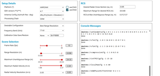

    I did it based on your recommendation and I have the following points (Sorry in advance if they a bit a lot):
    • I believe that the number of points are now more using DDM. But I notice that the spread of the points on the elevation level is below my expectations as I mentioned the Object is 2m long and I was putting the sensor on 1m high so I would expect that the points should be between -1m: 1m. Current output is as shown in the image.
    • I notice also that I always need to go to visualizer and send the config to mmwave device so that it starts sending the points out. I would like that the output comes out directly without the need to send the config.
    • I used the following configuration. Is there any other configuration or SW binaries that you would recommend. My Target FOV max range is 35m but I seek high resolution to be able to detect small objects as of size of a ball of 5cm radius.
  • Hi Ahmad,
    Firstly, AWR2944 demo is intended for Automotive applications. The configurations that are provided in the SDK, are for long range detections.
    Elevation angle resolution at boresight is given by θ = 2/N = 2/4 = 0.5 radians = 28.6 degrees. (N is number of virtual antennas in elevation direction). For detailed understanding, refer to MIMO Radar (Rev. A). To get a fine elevation resolution, you need more antennas in elevation direction.
    If you want to use the demo visualizer, you have to send the configuration via CLI for every run. If you are not going to use demo visualizer, follow the steps given below to bypass the CLI -
    • Navigate to C:\ti\mmwave_mcuplus_sdk_<ver>\mmwave_mcuplus_sdk_<ver>\ti\utils\cli\src\cli.c
    • Uncomment CLI_BYPASS macro
    • Rebuild cli library
    • And rebuild the demo application
    Detection of the target is based on the RCS, Tx output power, etc. I suggest you to check about the Radar Equation. We haven't tested AWR2944 demo detecting a small ball at 35m. Fine tune your parameters by referring to Programming Chirp Parameters in TI Radar Devices (Rev. A) based on your requirements.
    Samhitha
