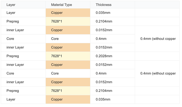

Hello Experts,
i was building pcb design and wanted to know the bare-minimum requirements for PCB.
I don't even need traces like LVDS i only need UART connection ( of course pcb will be as per swr166 / sprr418 - required parts only  )
i have read pcb stacks that were available on xWR6843AOP_HW_BringUp_Schematic_and_Layout_Checklist.
General information on the documents and forum is to use recommended stackup to avoid performance degradation.
however, i read that whole point of AOP is relaxed pcb requirements as antennas are on package.
i was wondering what is minimum i can get away with for prototyping / initial small manufacturing WITHOUT ANY performance degradation.
Please bare with me as i am quite new to this.
Is any of below sufficient for stripped down version of reference design ?
Thank you in advance for your help.

  • Hi there,
    If you want to reduce the overall PCB cost, you can go for four-layer PCB. Could you please let me know how many layers do you require?
    For a 4-layer PCB you can refer to the below stack-up:
    Also, the stack-up you have shared, could you please specify the dielectric type and more information about it?
    Also, please let me know what all communication interfaces you would require.

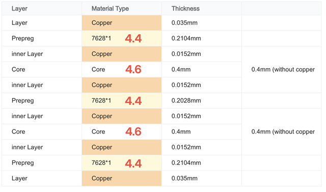

  • Hello Swarnendu,
    Thank you for your response.
    Dielectric type is FR4.
    Surface Finish: ENIG
    Thickness: 1.6mm
    Outer Copper Weight: 1oz
    Inner Copper Weight: 0.5oz
    Please find updated image i have written dielectric constant ( In red colour).

    I have reviewed the dielectric constants, this looks fine.
    FR4 material is okay.
    ENIG surface finish is also fine as the antenna is on the package itself.
    Overall PCB thickness of 1.6mm is okay.
    The copper weight is also okay.

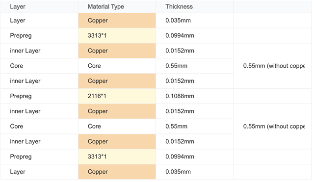

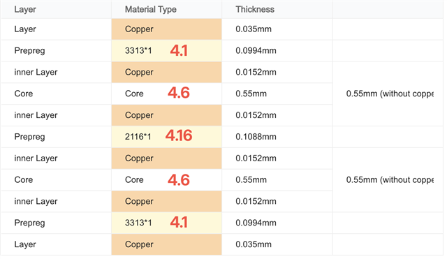

  • I had shared 2 stackups with you. both of them are okay to use ?
    do you recommend one over other ?

  • Maharshi,
    Both of the stack-ups that you shared are okay for RF and relevant performance for the IWR6843AOP.
