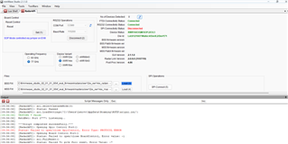

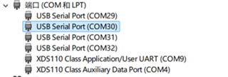

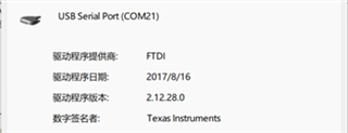

I am trying to connect the DCA1000EVM with mmWaveStudio 02_01_01_00, but after installing the FTDI device driver, the Device Manager shows the port name as "USB Serial Port" instead of "AR-DevPack-EVM-012" as specified in the manual. The port display is shown in the image below:
I have followed the solutions provided in the manual and other forum posts to update the driver in the path C:\ti\mmwave_studio_02_01_01_00\ftdi. The manual states that after updating the driver, the port names should sequentially change to "AR-DevPack-EVM-012". However, even after reconnecting the USB interface and reinstalling the driver, the port name still appears as "USB Serial Port". Upon checking the properties, the manufacturer and version number are displayed correctly and appear normal.
After connecting to the AWR1443 Boost, mmWaveStudio 02_01_01_00 immediately encounters errors during the initial Reset step:
Status: Failed to open/close GpioControl, Error Type: PROTOCOL ERROR.
Additionally, the system reports "0" for "No. of Devices Detected".

[09:05:31]  [RadarAPI]: Opening Gpio Control Port()
[09:05:31]  Status: Failed to open/close GpioControl, Error Type: PROTOCOL ERROR
[09:05:31]  [RadarAPI]: Opening Board Control Port()
[09:05:31]  [RadarAPI]: Status: Failed to open/close BoardControl, Error value: -1
[09:05:32]  [RadarAPI]: ar1.FullReset()
[09:05:32]  [RadarAPI]: Status: Failed To give full reset, Error Value: -7

Both the DCA1000EVM and AWR1443 Boost were configured according to the manual. The FPGA connection is functioning properly, and I even attempted to refresh the 1443 Boost using Uniflash before restarting mmWaveStudio. However, the previously mentioned errors persist.
      After replacing the original DCA1000EVM with another unit, the system operates normally. Could the engineers help identify what might be wrong with this specific DCA1000EVM unit?

  • Hi Jin,
    First of all, thank you for your response. After enabling the display of hidden devices, I did see the port records (AR-DevPack-EVM-012) previously connected to other DCA1000EVM devices.
    I then removed all of them. After reconnecting the device, it showed the following (as below)
    but even after updating the drivers, the port name AR-DevPack-EVM-012 still did not appear.
    Thank you!

  • Hi Jin,
    I have updated the drivers again on those USB serial ports, but the port name AR-DevPack-EVM-012 still does not appear. I’m wondering if my FTDI driver version is too outdated and whether I need to download a new version of the FTDI driver—and if so, where can I download it from?
    Thank you!

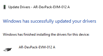

    I've tried to recreate the setup shown in your first screenshot:
    1. Connect to the DCA1000EVM FTDI and power it on. Delete the all instances of the USB serial ports/AR-DevPack-EVM from Ports (COMP & LPT) and Universal Serial Bus controllers section (If they are present on both).
    2. Disconnect and reconnect the DCA1000EVM. (Please try the next steps even if the devices show up as USB Serial Port for you)

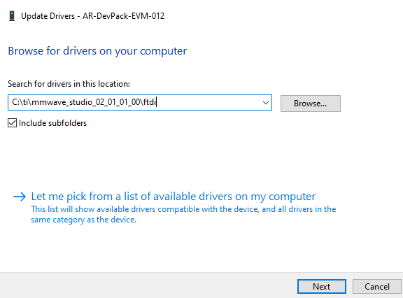

    3. Update the driver using the FTDI driver in the Studio package:
    (Right-click) device > Update Driver > Browse my computer for drivers > Search for drivers in this location: <mmwave studio directory>\ftdi:
    After clicking Next:

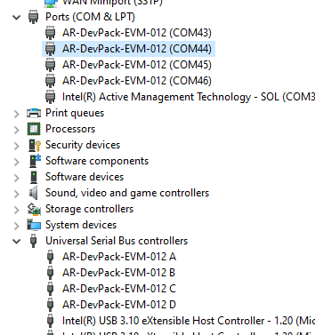

    4. It should now show up under Universal Serial Bus controllers:
    Do this for each device.
    5. Now, the AR-DevPack-EVM-012 A~D should show up under Universal Serial Bus controllers. There will also be unidentified USB Serial Port devices under Other devices.
    6. Update the drivers for each USB Serial Port device again, as explained in Step 3.
    Then, all 4 AR-DevPacks should show up under Ports (COM & LPT) and be good to use.
    Please give this a try and let me know at which step it is failing.
