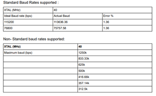

  • Hi Josh, Thanks for these valuable information. I have one more query , Can we configure the baud rate of the UART (Radar Sensor) if our MCU does not have the same baud rate? What are the available baud rates for the Radar Sensor 6432 ?
    Thank You.
    No problem! Regarding the UART baud rate of 6432, there is some flexibility to configure the baud rate. However, due to a design limitation related to the clocking scheme the UART doesn’t support standard baud rates above 115200 bits per second. Here are the supported baud rates. See the device errata for more information.
    Josh
  • Hi Josh, could we face a problem in UART communication if my MCU operates on baud rate 115200 and the radar sensor operates on baud rate 113636.36? Could it  lead to corrupt or mismatched data on receiver side?
    Additionally could we have an idea of estimated length of data bytes from the radar sensor through UART if I will only need the data of distance periodically?
    Thanks.
    This would depend on how tolerant your MCU is to baud rate mismatches. As you can see from the picture I shared, with a baud rate of 115200 the error is only 1.36%. This is generally considered an acceptable level.

  • Hello, the baud rate should not be an issue now because I have configured the UART for 500000 baud rate and send the data to COM Port which was correctly detected in my Dock light app.

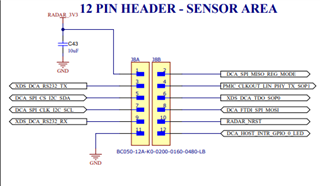

    Can I connect the UART lines of my MCU directly on the IWRL6432AOPEVM board to receive the data in to my MCU ?
    There is a small 12 pin header on the back of the "mission board" part of the IWRL6432AOP and this includes the UART pins. THis could be used for connecting to your MCU. Please refer to the EVM schematic and user guide.
    Josh
  • Hi Josh, are you talking about the Pin Number 3 & 9, Named XDS_DCA_RS232_TX and XDS_DCA_RS232_RX ? Is it RS232 bus? if yes, we can not connect it directly to my UART bus Right? Because both have different signal levels. So I want to clarify that can I connect them to my MCU's UART bus which is 3.3V or any converter is needed?
    Thank You.
    6432's IO voltage is 3.3V. You can connect directly to the UART of your MCU.
