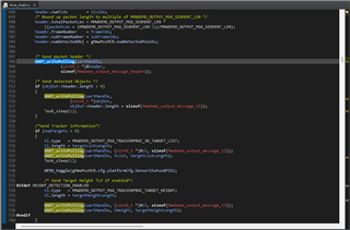

    Yes. I am using the industrial visualizer and add on some parsing output, so I can know what causing the parsing error.
    Using the 80ms frame period, in the end of the TLV=1020 data, there are portion of next TLV data (attached the snapshot of the data in picture below).
    In function MmwDemo_uartTxTask, I had tried to use "UART_writePolling" method instead of "UART_write". Is there any methods to confirm the FIFO had completely send out? There is no specific patterns in crashes after specific number of frame. This only happens when I am using the idlePowerMode.

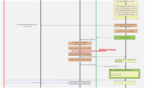

  • From <C:/ti/mmwave_sdk_03_06_02_00-LTS/packages/ti/demo/xwr68xx/mmw/docs/doxygen/html/index.html>, IdlePowerDown happens between "Send detected objects etc to UART" and "Process pending Dynamic Config Commands for next sub-frame". Do this need to be semaphore, waiting for IdlePowerDown done powering up, then continue "Process pending Dynamic Config Commands for net sub-frame"?
  • Are you following the instructions here?
    https://dev.ti.com/tirex/explore/node?a=1AslXXD__3.00.00.05&node=A__AOJjAWsYPq56ZxKYYyJH5A__radar_toolbox__1AslXXD__3.00.00.05
    Please do not change the UART calls from the default. I would just follow the instructions above.
    Nate
