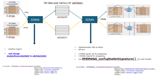

  • Hi, Zigang
    Thank you for your answer.
    I am trying to create (ADC buffer EDMA to ARM core memory + EDMA the data to HWA memory + HWA do range FFT) for one HWA loop at first. if it will be fine, I will try all HWA loop.
    I failed at second EDMA transfer. I think the trigger isn't working properly.
    Could you please check my EDMA transfer chain and function parameter set? or give me some advice?
    Thank you.
    JB
  • HI, JB:
    It will be hard for me to review your code. Are you chaining the second EDMA (from adcDataIn) to the first EDMA (from ADC data buffer to adcDataIn)? And then chaining the hotSig to the second EDMA?
    Zigang
  • Hi, Zigang
    I only changed shadowParam.destAddr to adcDataIn[idx].
    Could you please check my EDMA setting? I'm sorry for in detail code question. I'm analyzing the EDMA, but it seems like it will take more time to analyze clearly.
    1. In rangeProcHWA_ConfigEDMA_DataIn()
    => Replaced from HWA memory(hwaInpBuff) to M4 adc buf memory(adcDataIn)
    Q1. Should I modify more in first EDAM(rangeProcHWA_ConfigEDMA_DataIn())?
    2. Create two dataPipe channel for ping/pong transfer to HWA memory(M0,M1)
    Q2. DataIn and new two dataPipe channel has different channel number, is it right way?
    3. Create rangeProcHWA_ConfigEDMA_DataPipe() function and call after rangeProcHWA_ConfigEDMA_DataIn()
    4. Set two EDMA param-set of AB-sync
    * chaniningCfg
    chainingCfg.chainingChan = pHwConfig->edmaPipeCfg.dataPipeSignature[idx].channel;
    chainingCfg.isFinalChainingEnabled = true;
    chainingCfg.isIntermediateChainingEnabled = true;
    => Set ture isFinalChainingEnabled and isIntermediateChainingEnabled for next chain trigger
    (Please let me know I set wrong value)
    * DPEDMA_configSyncAB() input value
    errorCode = DPEDMA_configSyncAB(handle,
                                                                &pHwConfig->edmaPipeCfg.dataPipe[idx],
                                                                &chainingCfg,
                                                                &syncABCfg,
                                                                false, /* isEventTriggered */
                                                                false, /* isIntermediateTransferInterruptEnabled */
                                                                false, /*isFinalTransferInterruptEnabled */
                                                                NULL,
                                                                NULL,
                                                                NULL);
    => isEventTriggered, isIntermediateTransferInterruptEnabled, isFinalTransferInterruptEnabled are set to false because the transfer be done immediately.(Please let me know I set wrong value)
    5. Call DPEDMAHWA_configOneHotSignature()
    errorCode = DPEDMAHWA_configOneHotSignature(handle,
                                                                                        &pHwConfig->edmaPipeCfg.dataPipeSignature[idx],
                                                                                        rangeProcObj->initParms.hwaHandle,
                                                                                        rangeProcObj->dataInTrigger[idx],
                                                                                        false);
    => Call OneHotSignature function for each channel trigger.
    Thank you.
    JB

  • Hi, Zigang
    Thank you for help. I will wait.
    I'm wondering that the DataPipe structure for ADC buffer in mmw_demo works properly.
    because the two ADC buffer(one ADC buffer has ping and pong chirp) transfer sequentially to HWA M0 and M1 with a for-loop.
    (16xx/18xx Interference Mitigation example seems DataPipe structure transfers one ADC buffer)
    I assume that one number of ADC buffer can be used as DataPipe structure,
    but I'm not sure how about 2 number ADC buffers transfer using for-loop.
    Thank you.
    JB
  • Hi
    I would like to help you with this question.
    Have you already implemented the EDMA transfer from the ADC buffer to adcDataIn[0] and [1] Memory.
    I think this is the first part that you need to get to work
    There are 2 EDMA channels needed, one for ping, one for pong.
    For each transfer, when the transfer is completed there must be an ISR triggered to notify the application that the data is available.
    This must be implemented first.
    thank you
    Cesar
  • Hi Cesar,
    Thank you for coming to help.
    Before the first implementation you mentioned, I have a question.
    In rangeProcHWA_ConfigEDMA_DataIn() function,
    EDMA transfer is using shadow region.
    Can I keep shadow region function? or should be changed AB-sync function? for create DataPipe between ADC buffer and HWA memory.
    Thank you.
    JB
    In the EDMA training the term "Shadow" is actually called "Linking" Please see training video below to understand how it works.
    Every paramset MUST have a "Shadow" paramset that will re-initialize the values after transfer is complete. The content of the Shadow paramset must be identical to the initial values.
    See Minute 18:30 in this training video
    C6000Tm embedded design workshop | TI.com
    Thank you
    Cesar
