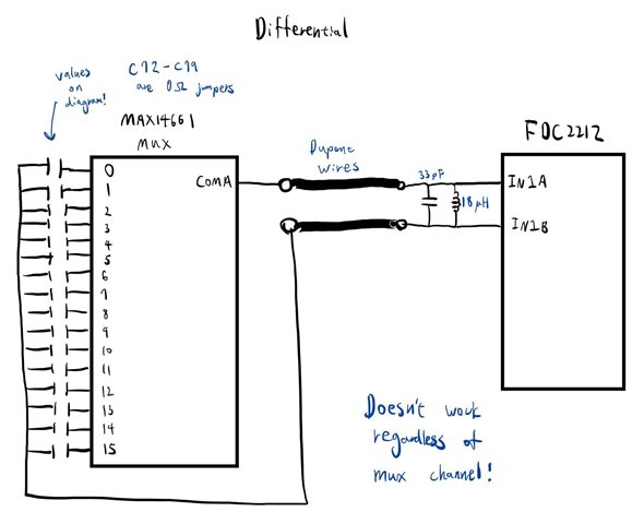

Hello everyone, I am attempting to use the FDC2212 to measure the capacitance drift of a number of SMD capacitors as they undergo various environmental temperature/pressure, and I am noticing that while it seems to work for pF range capacitors, the precision of the sensor dramatically goes down when the capacitance reaches nF levels. I am wondering if I am configuring my sensor in software incorrectly, or if I am reaching the maximum capacitance sensing range for my particular choice of inductors. Here is my circuit schematic (C+ on the MAX14661ETI_T multiplexer chip is connected to C2+ on the FDC, C- is connected to C2-, and I grounded CLKIN and am using the internal oscillator for all of these):

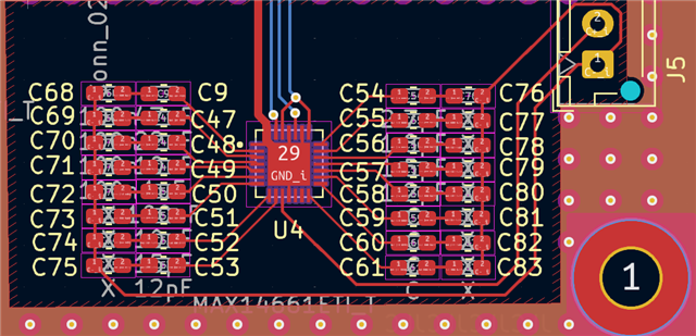

The layout are as the following, where the two boards are connected by wires (unshielded):
Now, I am aware that this is wired up in differential mode where the capacitors are getting measured across C2+ and C2-, so I did the following for the registers/capacitance measurement:

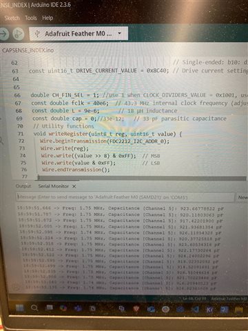

When I do that, it just outputs a negative capacitance when I measure across C68 and C9 (~100 nF). This is with the mux closed on ONLY that channel (and yes, I do see capacitances change when the mux closes on other channels instead). When I disconnected C- on the mux and grounded it instead (i.e., operated this on the single-ended mode), I switched CLOCK_DIVIDERS_VALUE to 0x2001 per the datasheet and am able to get positive (and somewhat reasonable-looking) capacitances as I switch between each channels. I logged the capacitance of all 16 channels over the course of 2 hours at 2 Hz sampling frequency and get the following statistics. Note that for CH0-5 (AB01-AB06, from 10 nF to 100 nF) the standard deviation and variance are orders of magnitude larger than the pF readings (CH12-15 are controls with no Cs installed).

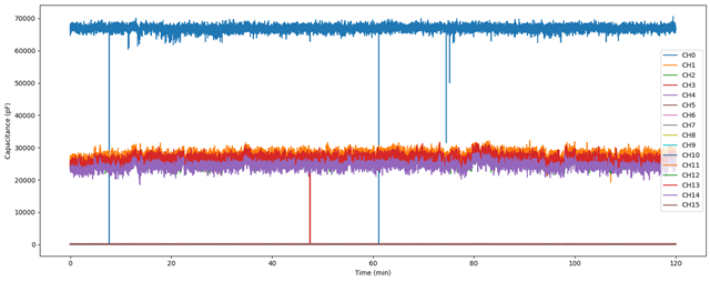

The test was done in an isolated environment with no movement/disturbance to any of the components. My understanding was that the FDC2212 was supposed to be able to measure fF level resolution capacitance up to 250 nF (or in my case with a 18 uH inductor in single-ended mode, 14 uF to 14 pF for fsense from 10 kHz to 10 MHz). My questions are:

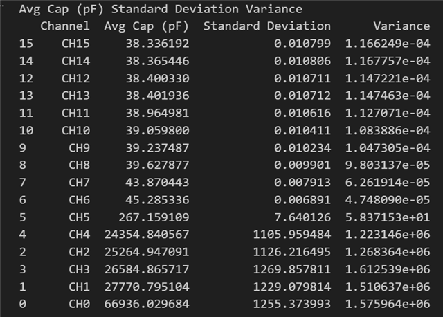

  1. Why is my capacitance reading so much noisier at higher capacitances at single ended mode (nF level noise)? Is this inevitable or is there a way to lower noise at higher capacitances?
  2. What are some reasons why my differential reading setup doesn't work? The capacitance should be more than high enough but my code says it's less than 33 pF which gives me a negative C from the capacitance calculation equation in the datasheet.
  3. Is my method of switching the output with a multiplexer legitimate if I put the device to sleep like that? I'm a bit uncertain why hot-swapping wouldn't work other than increasing settling time, since I don't get how a sudden change in capacitance from switching channels is different from the sensing capacitance changing quickly.

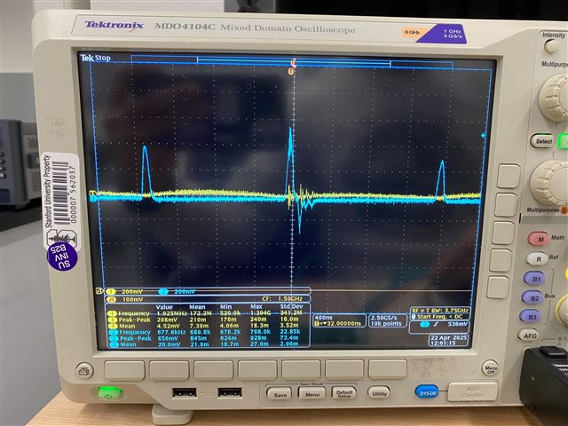

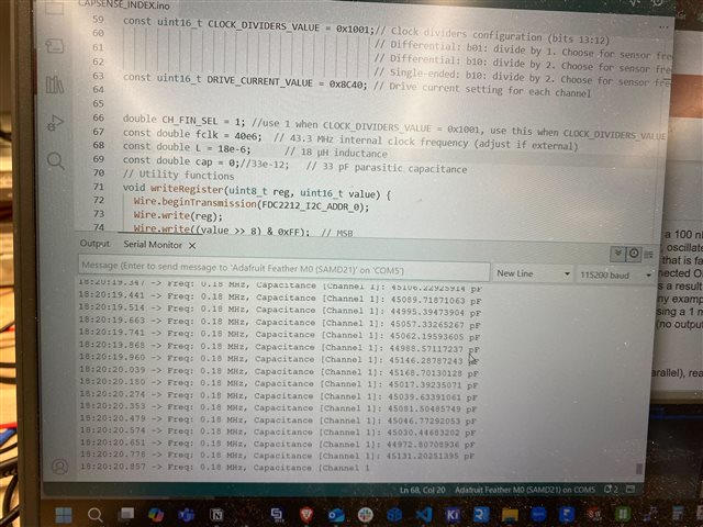

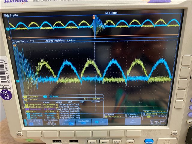

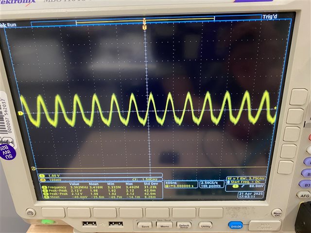

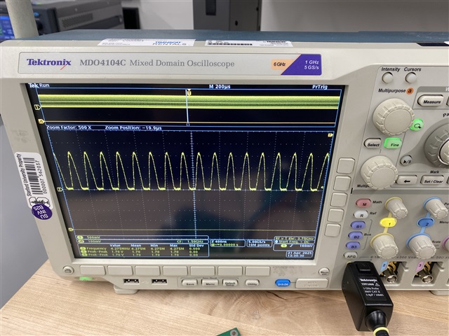

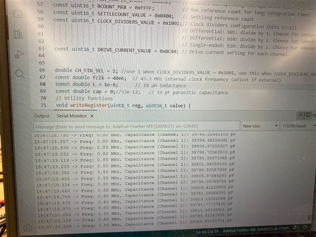

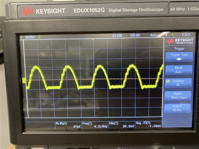

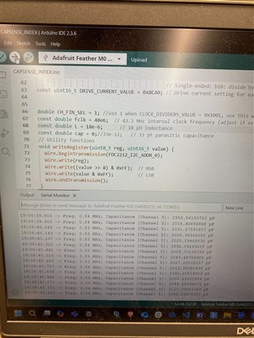

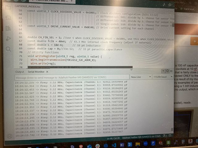

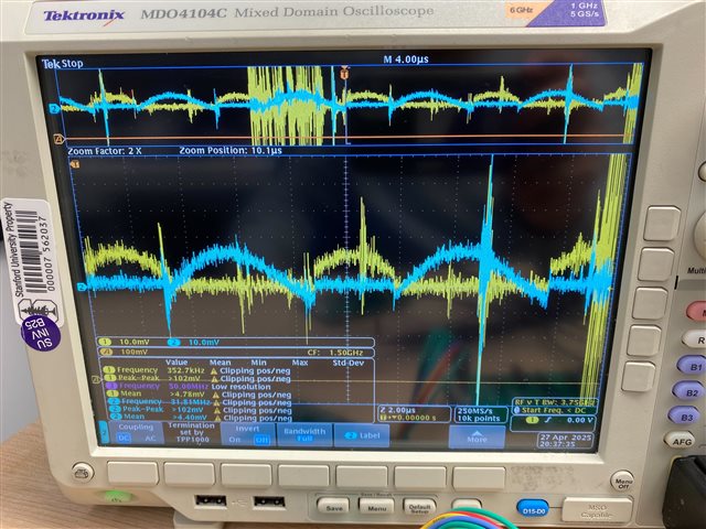

  • Hello John, thank you for your assistance I tried the steps you suggested and get essentially the following for channels 0-5:
      However on my serial output I get a frequency of about 0.13 MHz according to the chip itself for channel 0, 0.32 MHz for channels 1-4, and 2.54 MHz for channel 5. For channels 6-15 I get something like this with a reported frequency if about 4.22 MHz.
    I am measuring right at C+ with a 1M 16 pF probe hooked onto a 1.487k leaded resistor in series like what you suggested. From pg 7 of the datasheet under excitation it says the oscillation amplitude should be between 1.2 and 1.8 Vpp, so am I correct to assume that what I am seeing is too low? Any suggestions for how to correct this? Thanks again!
  • Bill,
    What pin/test point are you probing in your first plot?
    John
  • I probed the same pin/test points for all of the tests and stuck the leaded resistor there so it’s not moved between channel switches. I probed the circled green point:
    I just switched over to a higher impedance probe (10 Meg 3.9 pF) and see a p2p of 1.8V now, so I think that was a result of too low of an impedance from my measurement side. With this new probe (and at the same probe site) I see this for chan 6-15 (and still see nothing for chan 0-5):
    According to my understanding, the Fsense is dictated by 1/(2pi*sqrt(LC)), which means my L of 18e-6 should give me a range of 140 pF to 14 uF right? But I am able to get a C of just ~70 pF (40ish pF from serial printout minus the 33 pF I subtract in software). This is strange to me.

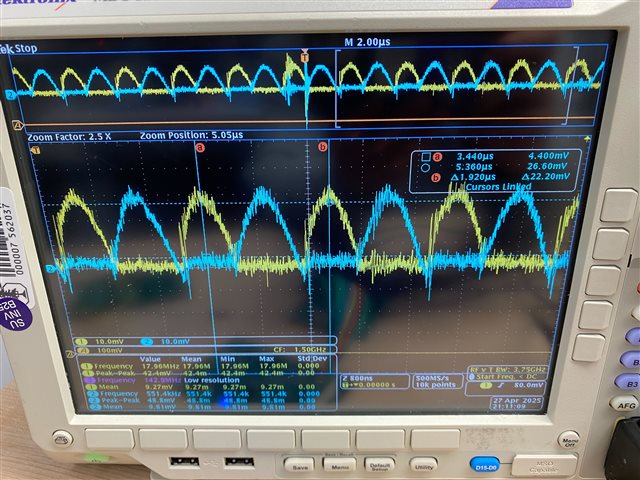

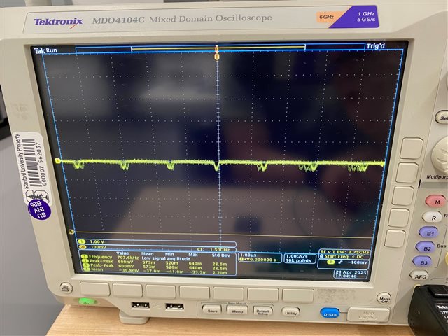

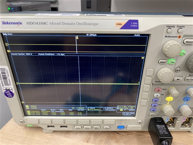

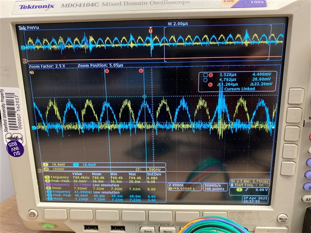

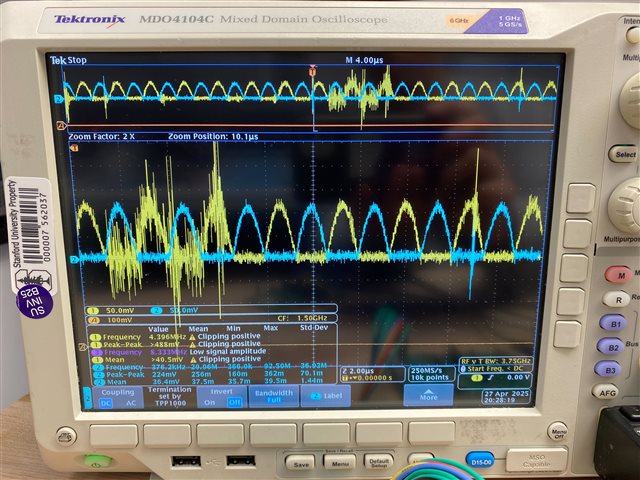

  • I did the characterization above in the single-ended coil configuration, but I would like to do it in differential for my actual project. The coil waveform looks like a complete sine wave when I measure across C+ and C- for channels 6-15:
    For channels 0-4, I just get a flat line. Interestingly for channel 5 (which is 10 nF instead of 100 nF) I get some half waveform that only shows up on the negative side whose frequency matches with what I see in my serial print (0.7 MHz):
    Any idea how to interpret this? Sorry that I accidentally marked this as resolved, it is not resolved yet :) Is there a way to un-resolve a post?
  • Bill,
    Marking the thread as Resolved won't be a problem. We can keep going.
    The waveform that should appear across the LC tank (connected to INxA and INxB) should look like a full, balanced sinusoid centered at 0V, with a peak amplitude between 1.2V and 1.8V. To measure this way on an oscope usually requires two high impedance probes with the oscope taking the difference between the two channels.
    The single-ended waveforms on each side of the tank circuit should like like symmetrical, balanced half-sinusoids that are 180 degrees out-of-phase.
    Are you seeing this on all of your channels?
    John

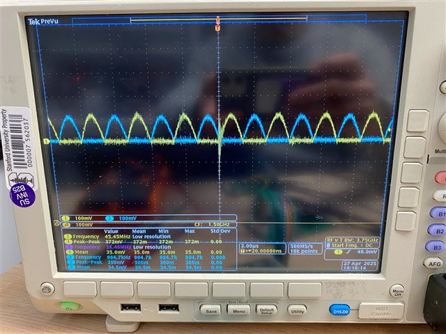

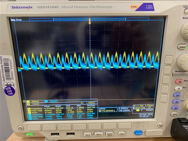

  • Got it, thank you John. I see that for channels 6-15 like what I said above, but not for channels 0-4. For channel 5, I see a slight sinusoid on the negative side of channel 6 but nothing on the positive side. I had two 10 Meg 3.9 pF probes connected to 1.495k resistors probing both channels relative to ground:
    Waveform for channels 6-15 (slight frequency changes between those channels, yellow is C+ and blue is C-):
    Waveform for channel 6 (10 nF load, yellow is C+ and blue is C-):

    Are there analog multiplexers between the electrodes+LC tank circuits and the FDC INx pins?
    John

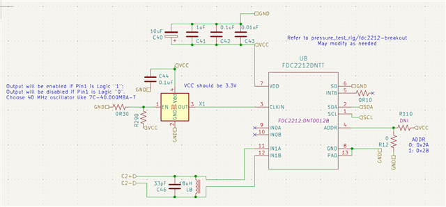

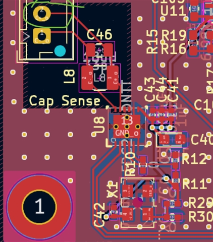

  • The FDC INx pins go straight to the parallel 18 uH inductor and 33 pF capacitor as seen in the layout, then that goes into a cable that goes to the analog multiplexer that connects to all these different capacitors. My intuition is that if the multiplexer is causing issues it wouldn't just be happening on some channels but not others. Do you see an issue with my layout of the FDC and the LC tank (4th image on the first post)?

  • When you say remove the sense electrodes, do you mean disconnect the cable from the mux end (i.e., the only thing connected to the INx pins would be the cable and the 18 uH inductor and 33 pF capacitor in parallel)? With the connected cable and the mux connected, it still oscillates if the capacitor connected to the mux channel is <10 nF (see examples above when it's connected to pF level caps or no capacitor at all). In differential mode though (when C- is connected to C2-) it never works even with the mux not connected to anything (but it does work with the cable connected to C2-. Here's a summary:
    1. Just cable connected to C2- and C2+: works
    2. Cables connected to C2- and C2+, C2- cable not connected to anything else and C2+ connected to mux that isn't connecting it with any channel: works
    3. Cables connected to C2- and C2+, C2- cable not connected to anything else and C2+ connected to mux that connects to channels 6-15: works
    4. Cables connected to C2- and C2+, C2- cable not connected to anything else and C2+ connected to mux that connects to channels 0-5: doesn't work
    5. Cables connected to C2- and C2+, C2- cable connected to C-: doesn't work regardless of whether C2+ cable is connected to anything/what the mux is selected to
    This leads me to believe that what I'm doing where I wire C- up to one end of all the capacitors is throwing C2- off and that when in single ended mode (first 4 cases I listed) it doesn't work when the capacitance is too high. The question is why is this happening and how do I fix it?
  • Bill,
    I'm having a little trouble understanding the topology of your single-ended and diff electrodes in terms of the diagrams you posted earlier.
    Are there simpler diagrams of those connections?
    For the differential mode connections, with everything but the MUX disconnected, the reduced parasitics may be forcing the LC tank resonant frequency above 10MHz, which is too high for these devices. Adding some add'l PCB capacitance and seeing if that allows the LC oscillator to have a stable signal (across INxA and INxB) could show you are getting more 'C' than you should from the electrode and cable capacitance.
    What I tried to propose was to first remove just the electrode, then the cable, and then the MUX, all the while monitoring the waveform across the corresponding INxA and INxB device pins. The goal was to see if one of those three connections (or all of them) was responsible for distortion of the waveform across INxA and INxB pins, which the device interprets as the input signal. Until we can establish all of the input signals look okay there isn't much sense in looking a the device outputs.

  • Here are some simple diagrams I drew showing what the connections are and their results:
    So in short, as long as the IN1B wire is connected to the other end of the capacitors the FDC output does not oscillate (probed at IN1A and IN1B relative to GND like your previous suggestion). This is true even if none of the capacitors are connected to COMA (i.e., connected to IN1A), and I tested that by programming the mux so that COMA is left floating with all the other channels floating as well. For single-ended, this diagram sums up my observations:
    Do these diagrams clear it up? What other configuration are you looking for to understand what's happening? I only see significant distortion when IN1B is connected to the other end of the capacitors or when IN1A is connected to channels 0-5 (i.e., 100 nF capacitors) or channel 6 (10 nF cap, negative oscillation exists but amplitude is very low).

  • I changed my system to run off of an external 40 MHz oscillator instead of the internal oscillator, and for some reason that seems to have allowed me to do differential readings (first figure I posted in my last post) without causing problems, but the system still doesn't work at C in the nF range. To determine whether the mux/cables are causing the problem like what you suggested, I tried disconnecting the two cables from the FDC2212 and just swapping the 33 pF capacitor for a 100 nF capacitor, and the sensor does not oscillate, even when I decreased the inductor size to just 1 uH. It does, however, oscillate at 10 nF, but with very low amplitude (100 mV). It still registered on the FDC2212 readout as 10,392 pF though, so that is fairly close (and surprising the low amplitude is picked up by the device). This is with the IN1A and IN1B pins connected ONLY to the capacitor and the inductor with the oscilloscope probes on both pins. I don't believe the issue I am having is a result of my mux now, as I can't read anything in the 100 nF range even with absolutely nothing else connected. Are there any examples of people reading capacitances in the nF range? I see in the datasheet they said they achieved a 250 nF reading using a 1 mH inductor, but with my 1 uH inductor I can barely read 10 nF (amplitude ~60 mV). At 100 nF, the device just freezes (no output, which means unread conversion flag is never on). See below:
    FDC2212 IN1A and IN1B connected only to a 10 nF capacitor and 18 uH inductor, reads 10400 nF:
    FDC2212 IN1A and IN1B connected only to a 10 nF capacitor and 9 uH inductor (two 18 uH in parallel), reads 10,392 nF:
    FDC2212 IN1A and IN1B connected only to a 10 nF capacitor and a 1 uH inductor, reads 8936.03320757 pF:
    FDC2212 IN1A and IN1B connected only to a 100 nF capacitor and a 18 uH inductor, reads all over the place but around 90,000 pF:
    And again with the 1 uH inductor, it doesn't read anything at all. Here's another contrast with a 1 uH inductor or 18 uH inductor, both connected to a 47 nF capacitor. This is what the 1 uH inductor waveform looks like:
    And this is what it looks like with the original 18 uH inductor:
    As a whole, I don't really see much of an improvement from decreasing inductor values for higher C like what I would expect, and this is with no mux and no cable.
    Here's one with the entire system in differential mode now (33 pF cap back, cables, mux, and indexed to channel 5 with the 100 nF capacitor). With 9 uH I get a Vpp of about 42 mV and a period of 1.920 us which is roughly 521kHz, or 10.37 nF in capacitance. However the FDC2212 is unable to read that and output a reasonable value since the amplitude is so low:
    For 18 uH, I get essentially the same thing (2.736 us => 365497 Hz => 10.5 nF) but with a larger amplitude (which I'm guessing is what I want?), but again the FDC doesn't pick up on the signal.
    This looks like the frequency is actually changing how we want it to, but the sine waves are just getting extremely attenuated at higher C regardless of L values (tried 1 uH, 9 uH, and 18 uH, and 18 uH has the least attenuation for some reason). Any suggestions/idea for what is causing this attenuation?

  • I don’t mind what the frequency of the sensor is, but I need to be able to sense higher capacitances (up to ~100 nF and down to 1-2 pF). As such I can’t just limit it to pF range capacitors. I purchased this device with the understanding that it would be able to measure to at least 250 nF, so that’s what I’m intending to do.

    If you place a 18uH coil and a 33pF cap across the INxA and INxB inputs, w/o cables or anything else connected, what do you see for INxA and INxB waveforms?
    John
  • If I just have a 18 uH coil and the 33 pF cap across the inputs, I can read around 50ish pF from the frequency and the waveform on both inputs look good. It’s only when the capacitance goes up to the nF range that it stops to work.
