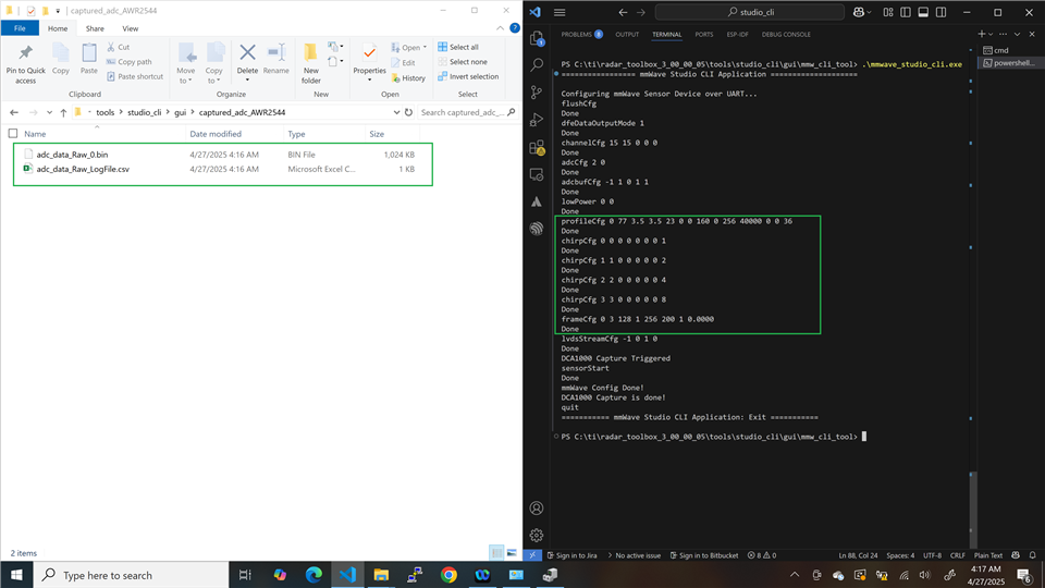

  • Data collection with config #1: 1 frame, 200ms frame period, 4 Tx, 4 Rx, TDM mode, 256 ADC samples, 128 chirps. (cfg file attached).
==> Expected bin file size: (ADCSample * Chirps * nTx * nRx * bytes_per_ADCSample) = 256 * 128 * 4 * 4 * 2 = 1,048,576 Byte (or 1024KB, as awr2544 has real only ADC sample, so each sample length is 2 byte).
==> I got a bin file with 1024KB as expected.

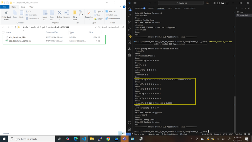

  • Data collection with config #2: 1 frame, 200ms frame period, 4 Tx, 4 Rx, TDM mode, 512 ADC samples, 128 chirps. (same as cfg #1, just change number of adc sample to 512 for better range resolution)
==> Expected bin file size: (ADCSample * Chirps * nTx * nRx * bytes_per_ADCSample) = 512 * 128 * 4 * 4 * 2 = 2,097,152 Byte
==> However, I got a bin file with only 1024KB, instead of 2048KB as expected. (snapshot attached)

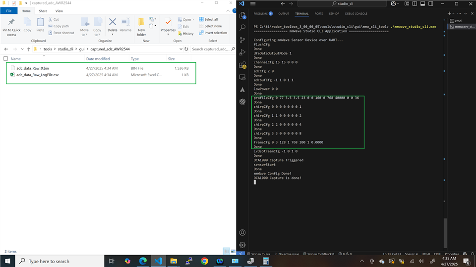

  • Data collection with config #3: 1 frame, 200ms frame period, 4 Tx, 4 Rx, TDM mode, 768 ADC samples, 128 chirps. (same as cfg #1, just change number of adc sample to 768)
==> Expected bin file size: (ADCSample * Chirps * nTx * nRx * bytes_per_ADCSample) = 768 * 128 * 4 * 4 * 2 = 3,145,728 Byte
==> However, I got a bin file with only 1536KB, instead of 3072KB as expected. (snapshot attached)
    --> Checked the last ADC data value presented in the last UDP packet and saved into bin file correctly. [Passed]
    --> Bin file size, after application has ran, was as expected. [Passed]
    --> Checked the last ADC data value didn't present in the last UDP packet and didn't save into bin file. [Failed]
    --> Bin file size, after application has ran, was only a half of the expected size. [Failed]
    --> Checked the last ADC data value presented in the last UDP packet and saved into bin file. [Passed]
    --> However, bin file size, after application has ran, was only a half of the expected size. [Failed]

  • Hello Saswat,
    I think I figured out the root cause. It was because the waveform profile config I used, the chirp time was shorter than the required time for the generated ADC data to be transferred. I extended the chirp idle time, then I got the ADC data transferred and captured properly by DCA capture tool.
    profileCfg 0 77 3.5 3.5 23 0 0 160 0 512 40000 0 0 36
    The limitation regarding ADC data transfer rate already mentioned in mmwave_plus_sdk_release_note. (Point #6)
    However, it's still a bit unclear to me that the profile config needs to ensure the generated data per chip can be transfer within chirp idle time
    ADC data transfer rate is limited by HSI Clock configured in SDK (1000MHz which is
    500 Mbps); ensure the generated data per chirp can be transferred within chirp idle
    time.
    ==> Ensure that Chirp idle time > ADC data per chirp / 500 Mbps where ADC
    data per chirp = Number of ADC samples * Number of Rx * 16 bits.
    Per my understanding, ADC buffer is a ping/pong buffer, so just need to ensure that the generated data per chirp can be transferred with chirp cycle time (idle + ramp end time).
    Please let me know if my understanding is incorrect.
    QHLam
