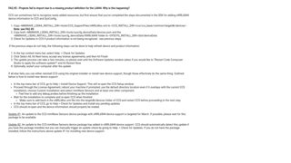

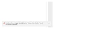

I tried to import the xWRL6844 out of box demo project in the CCS version: 20.11,  from the low power SDK: MMWAVE_L_SDK_06_00_03_00. The below error popped up.
So I followed the instructions mentioned in the document: https://e2e.ti.com/support/sensors-group/sensors/f/sensors-forum/1454555/faq-awrl6844evm-common-questions-and-resources-for-xwrl6844
After these steps also, I was not able to import the Out-of-box demo project.

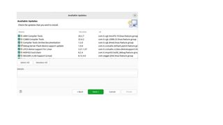

So I migrated to the CCS version: 12.8
There I faced the Device not found error,then I clicked on the “Install device support” and re-ran the installation process.
Then I clicked the “Check for updates” and selected all the components:
Now I am able to import the Out of box demo project.

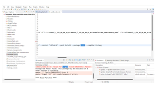

    I tried with the above one. I am able to import the project.
    When building it, the following error throws up:
    I have mentioned the versions of the tools used for configuring the project:
    The error is that the FCCSP package is not available in the Sysconfig tool. Bu the Sysconfig is already at its latest version.
    Please help us with issue !!
  • Hey Poorneka,
    Thank you for sharing the errors you were running into. It appears the SysConfig device data is missing, though it should've been present upon downloading SysConfig. You can add it back manually by navigating to <MMWAVE_LSDK6_INSTALL_DIR>\tools\syscfg_deviceData, copy the XWRL684X folder and devices.json, and then navigate to your SysConfig 1.23.1 device data directory - likely C:\ti\sysconfig_1.23.0\dist\deviceData - and paste in the folder and .json file.
