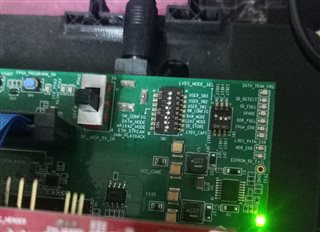

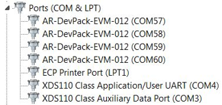

  • I downloaded the lattice tool, but it doesn't recognise my device. I have configured the switch settings as given in the DCA1000 user guide chapter 9 (Attached images) and followed the steps. But I get the below error
    Do you see the four DevPack ports in Device Manager? If not ensure the FTDI drivers are installed.
    Make sure all the switches are correct and you have a 5V 3A power supply, cable to the FTDI port of the DCA1000, ethernet port of the DCA1000, and XDS port of the mmWaveSensor

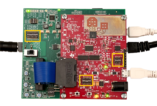

  • Yes, I can see the four devpack ports. I have the switches as shown in the picture. I have a 5V 3A  adaptor to the DCA1000 and a 5V 2A adaptor to the sensor. Will that be an issue?

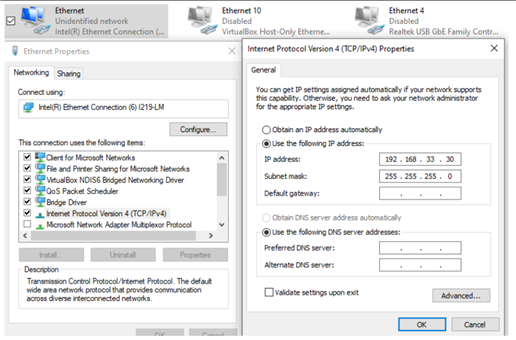

  • If the four DevPack drivers are appearing, then the FTDI drivers are installed and is detecting the DCA1000. Detecting is different than full communication, but is a good start. Do you set your static IP to 192.168.33.30 as well?
    Also, in your picture I do not see a USB cable connected to the mmWave sensor itself. You need two USB cables, one from DCA1000's FTDI USB port and one from 6432's XDS USB port.

  • I have set the static IP address and also used two USB cables. But still facing the same problem. I have a 5V 3A  adapter for the DCA1000 and a 5V 2A adapter for the sensor. Will that be an issue?
    Could you try different USB and Ethernet cables? And to be certain you added the two .exe's listed prior to your firewall list correct?
