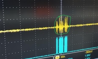

  • Well, we arrived to some configuration parameters and handling of the TDC1000 that seem to work well, and may be useful to other TDC1000 users that want the LNA/PGA Rx line only, and always active.
    The main idea is to make an unique TX trigger, with some Tx pulses, and predict a delay from trigger pulse that asures that the Rx line is active, in ECHO LISTEN stage. At that moment, turn-off CLKIN signal, so that the state machine remains still, in that stage. The PGA gain remains configurable (the SPI works well so the register is written), and the gain changes accordingly.
     As a reference, the process can be:
    1) Fix a number of Tx pulses greater than 0 (we used 3), some TX_FREQ_DIV (this affect the delay computation)
    e.g.: 0x00, 0b01000011 (Nºregister, bit values)
    2) Set high numbers of RX echoes expected (we set 7).  0x01, 0b00000111
    3) Set a high echo threshold (just in case, in our case we don't want any detection at all). 0x03, 0b00000111
    4) Receive mode in multi echo enabled mode (bit 6 of Reg 4, others bits doesn't care much).  0x04, 0b01011111
    5) Echo timeout disabled and long timeout config (MSB) -> Standard TOF Measurement. 0x08, 0b00000111
    6) Make the trigger pulse, and wait the amount of time required to assure ECHO LISTEN stage (we set 150 us in our case, the minimum time comes from T0 and T1).
    (Note: We used a 2 MHz CLKIN.)
    T₀ = 1/CLKIN = 0.5 us
    T₁ = TX_FREQ_DIV·T₀ = 4 us TX_FREQ_DIV=2 -> %8
    AUTOZERO_PERIOD=0
    tlisten≈NUM_Tx×T1+128×T0+2^AUTOZERO_PERIOD×64×T0= 3·(8·T₀) + 128·T₀ + 64·T₀
    = 108·T₀ = 54us
    7) Deactivate the CLKIN signal and do not retrigger (one shot).

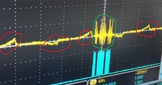

    With that configuration, we obtained the following (yellow - output of PGA)
    Similar one-trigger configuration, but WITHOUT disabling CLKIN presents some issues.
    Periodically trigger didn't worked well.
