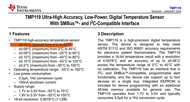

Please see Ren's response at the end of this post: https://e2e.ti.com/support/sensors-group/sensors/f/sensors-forum/915275/tmp117-calibrating-to-0-05c-50mk-accuracy
Alternatively, depending on the expected temperature range in your application, you could employ the TMP119.
