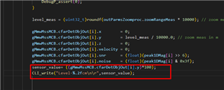

  • I have enabled Quick Eval in the SysConfig file to hardcode the CLI configurations (in mmw_cli.c).
  • I'm currently sending the level sensing data via UART using the CLI_write function.
  • The transmitted data is successfully visible in a serial monitor (screenshot attached for reference).

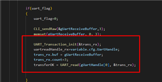

Steps Taken to Enable UARTB Interrupt Mode:
  1. In SysConfig, I changed the UART read transfer mode to Callback and assigned a read transfer callback function.
  2. The callback function definition was added to level_sensing.c.
  3. I attempted to reinitialize the UART and assign the callback each time the callback function is executed.
Issue:
After these changes, I encountered several errors as a Garbage. I have attached the modified code and error logs for reference.
